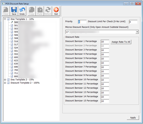

POS Discount Rate Setup
This figure shows the POS Discount Rate Setup
  1. From the Administration, POS Discount menu, select POS Discount Rate.
  2. In the POS Discount Rate Setup window, expand the tree view of the discount level to display the Revenue Center.
  3. Select Revenue Center of the discount level.
  4. Assign the discount priority number in the Priority field for each of the outlets. The lower priority number would have a higher chance for the discount to be applied to the guest with the same cabin and booking number. For more information, see Discount Level Assignment.
  5. Enter the total discount limit per sales check in the Discount Limit Per Check (0-No Limit) field. For more information, see Discount Limit Per Check.
  6. In the MICROS Discount Record (Only Open Amount Subtotal Discount) drop-down list, select the POS discount record discount key. See Setting Up POS Discount Key
  7. In the Discount itemizer 1 Percentage, enter the discount rate.
  8. To apply the same discount rate to the rest of the discount itemizers, click Assign Rate To All.
  9. Click Apply to save.
