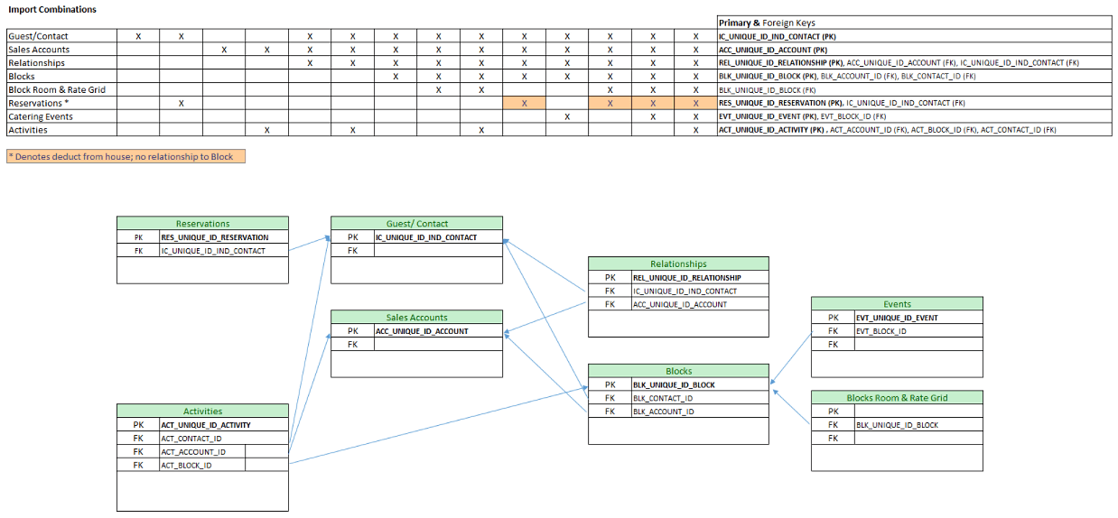

This image shows the template used for importing data.
The data import utility is intended for all entities to be uploaded, validated and imported in one cycle to ensure data consistency.
  • You can import data type: Individual/Contact profiles only.
  • You can import data type: Accounts only.
  • You can import data types: Individual/Contact profiles and Accounts together.
  • You can import data types: Individual/Contact profiles, Accounts and Relationships together. The unique Id's for Accounts and Individual/Contact profiles referenced in the Relationships data type files must exist in the respective Accounts and Individual/Contact profiles data type files.
  • You can import data types: Individual/Contact profiles and Reservations together. The unique Id's for Individual/Contact profiles in the Reservations data type files must exist in the respective Individual/Contact profiles data type files.
  • You can import data types: Individual/Contact profiles, Accounts, Relationships and Reservations together.
    • The unique Id's for Individual/Contact and Account profiles referenced in the Reservations data type files must exist in the respective Accounts and Individual/Contact profiles data type files.
    • The unique Id's for Accounts and Individual/Contact profiles referenced in the Relationships data type files must exist in the respective Accounts and Individual/Contact profiles data type files.
You have 14 days from the first successful file upload to complete the data import cycle. If the data import cycle has not been completed in 14 days, you will need to restart the data import process again.

Data Type / Entity Relationships
This image displays the Data Type/ Entity Relationship diagram.
To establish the relationship between records in each data type, the Unique ID primary key (PK) values are referenced as the foreign key (FK) IDs in other entities.

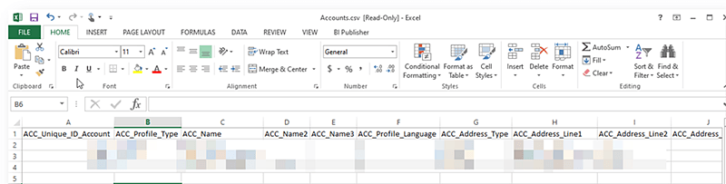

Preparing Template Data Files
  1. From the side menu select Toolbox, select System Setup then Import Data.
  2. Click Download Templates to download a templates.zip file to your workstation.
  3. Open the ZIP file and extract the CSV files to a folder.
  4. Navigate to the folder, open and prepare the CSV file data based on the templates requirements.
    Each data file created must have a maximum file size of 10MB; you can upload and import multiple files per data type. Uniquely name each file. For example: Account01.csv and Accounts02.csv.

Column Name Description Max Data Length Sample Data Mandatory
ACC_Unique_ID_Account (PK)
Unique ID value for Sales Account in the uploaded csv files for data type Accounts within an import cycle.
Ex: (40001, AC40001)
supported icon
ACC_Profile_Type
The type of sales account. The account type can be TA, Source, and Company.
Ex: ( TA, Source, Company)
supported icon
