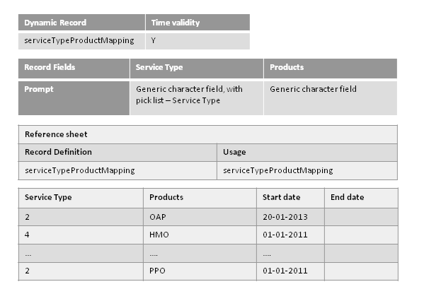

The dynamic logic condition requires a reference sheet to be set up. This reference sheet contains the list of service types and product mappings. The list of products that is returned after addressing the reference sheet is then validated against the policy products received from the enrollment response.
The reference sheet is setup as shown in the image below:
Reference Sheet Benefits
The reference sheet is associated to the dynamic logic condition 'DYLO_VAL_SERVICE_TYPE_PROD'. The condition dynamic logic evaluates to true if the person or object is not enrolled for any of the required products and the message 'MSG_SERVICE_TYPE_PROD' is then attached to the authorization.
