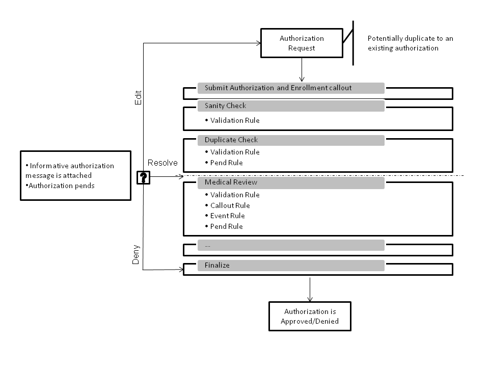

Scenario Duplicate Check
What if?
Many different configurations could lead to a similar outcome when a request is processed for the first time. However, a configuration may result into a different outcome during reprocessing. Consider that instead of the validation rule, the pend rule condition is implemented to check for duplicates. The authorization request will pend if it is a potential duplicate and a workflow message will also be sent out. However, if such a request is reprocessed, even if the pend rule condition detects that the authorization is a potential match, the authorization will not pend (as the reattach indicator is set to 'N') and there will be no visible indication or warning. If such a warning is desired then it is necessary to implement the check through a validation rule.
Here, by implementing a validation rule; message MSG_VAL_DUPECHECK will always be attached to the authorization whenever the system detects it to be a potential duplicate. For the first time it will result into a pend and for the second time it will not (as reattach is 'N').
