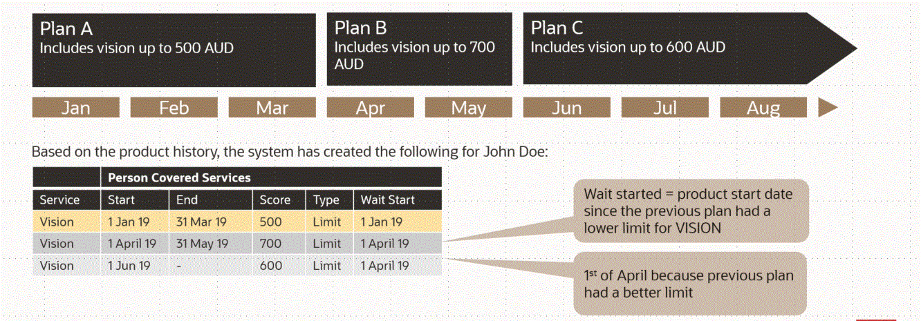

The person-covered services holds possible combinations of the products the member is or was enrolled in and the service option service codes[1] for those products.
If the product holds product parameters for limits and cover withhold categories, [2] there are separate person-covered services for both types, which means that the wait start date for the limits can be different from the wait start date for the parameters.
The following image displays enrollment data for member John Doe and the resulting person-covered services. This example applies only to the person-covered services of service type limit.

If product benefit specification parameters apply and during waiting period evaluation the waiting period was served by a previous product, the lower of the parameter values from the two product benefit specfications must be used.
For example:
Table 14. When Introducing a New Waiting Period
Product Limit Parameter Copay parameter
Previous product A
100 (= less)
100 (= better)
Current Product B
200 (= better)
200 (= less)
If the waiting period was served based on product B, use Limit 200 and Copay 200 If the waiting period was served based on previous product A: use Limit 100 and Copay 200 (worst of both worlds).
