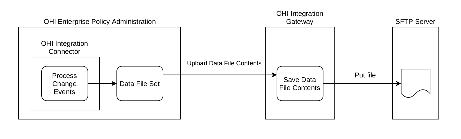

Synchronized Group Data
In this case, OHI Enterprise Policy Policies invokes Oracle Insurance Gateway using the file upload mechanism whenever the data gets changed in OHI Enterprise Policy Administration. This is made possible by configuring change event rules of type - "Message" in OHI Enterprise Policy Administration. For details on configuring change event rule, refer to OHI Enterprise Policy Administration - Change Events guide .
The ORBM specific file gets produced by OHI Enterprise Policy Administration, and gets uploaded to Oracle Insurance Gateway using multipart/form-data. The gateway saves the Data File contents for each Data File in the Data File Set and sends these contents via SFTP/REST to the destination (ORMB).
If Oracle Insurance Gateway needs to transmit the contents of each Data File to a configured SFTP location, then an SFTP Destination ORMBSFTP must be set up. Such a destination can be set up by sending in the following request to Generic API /sftpdestinations :

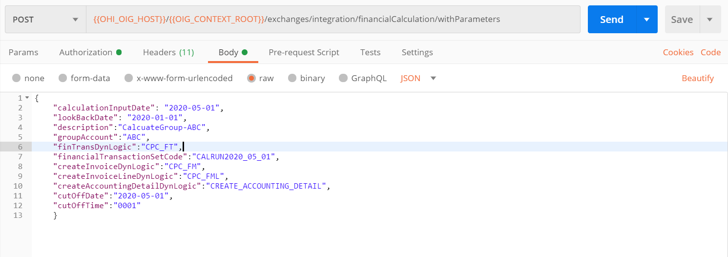

The image below shows the invocation of this integration using Exchange Integration Point - With Parameters
The financial message generated by OHI is accessible to FinMessageTransformation dynamic logic through bind variable 'finanicalMessageOHI'. The financial message gets transformed into ORMB message using transformation dynamic logic and is SFTP to ORBM (via destination 'ORMBSFTP') (see the previous example, for destination configuration) using DELIVERY step 'finMessageTransDeliver'
