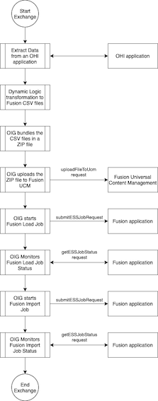

For the Load and Import Data use case the Oracle Insurance Gateway executes the following steps:
Upload a zip file to the Fusion Universal Content Management (UCM) server. This is invoking the uploadFileToUcm SOAP request.
Start a job for loading the zip file contents into Fusion’s interface tables. The load job is started through the submitESSJobRequest SOAP request.
Monitor the status of the load job using the getESSJobStatus SOAP request. This is repeated periodically until the job status that is received indicates that the job reached an end state: it either succeeded or failed.
When the data was loaded successfully into the interface tables: start a job for importing the data from the open interface tables into the Fusion application. The import job is also started through the submitESSJobRequest SOAP request.
Monitor the status of the import job using the getESSJobStatus SOAP request. This is repeated periodically until the job status that is received indicates that the job reached an end state: it either succeeded or failed.
This use case is encapsulated in a specific Destination called "FUSIONLOAD", it is not needed to define separate Integration Steps to execute these processes in Fusion.
The following graphic shows an overview of the steps executed as part of an Oracle Insurance Gateway Fusion integration that extracts data from an OHI application and loads and imports that data into Fusion:
The overview depicts the scenario in which all steps succeed. If a step in the process would fail that fails the Oracle Insurance Gateway exchange. It can be restarted after resolving the problem.
