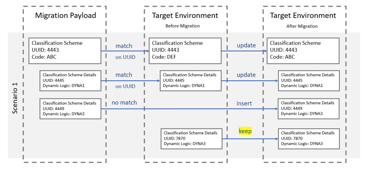

Switching off Delete by Omission
The ‘delete by omission’ behavior is enabled by default. The user can override this behavior either when creating a new migration set in the source environment or when importing a migration set in the target environment. This behavior applies across all entities in the migration set; either all dependent items are deleted by omission or none of them are.
If the user overrides the behavior upon generation of the migration set, then the payload is marked so that the target system knows not to delete by omission. If the user specifies the desired delete behavior upon importing a migration set, then the import ignores the whatever instructions are included in the payload.
Migration behavior without Delete by Omission
To clarify this feature, consider the image above. The default system behavior removes item 7870 but if the user disables the ‘delete by omission’ feature then item 7870 remains unaffected.
