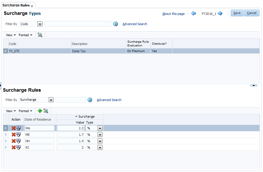

Surcharge types are in fact Schedule Definitions of the type surcharge. A schedule definition specifies which columns (called dimensions) appear for its surcharge rules. It also connects the values in those columns to the values on the person or object or the policy, so that the application knows how to evaluate the surcharge rules during the premium calculation. For the example in the image above, that means connecting (comparing) the state on the surcharge rule to the state of the insured person’s current living address.

Note that in the mock-up below the State of Residence field is configured as an additional dimension.

Now that the schedule definition has been created, a new surcharge type has become available in the surcharge page. The next step is to set up surcharge rules the new type.
| Surcharge Type | |
Code |
Description |
TX_STE |
State Tax |
| Surcharge Rules | |
State of Residence |
Surcharge |
ME |
1.7 % |
MA |
2.3 % |
NH |
1.4 % |
RI |
2.0 % |
The surcharge rule configuration is now complete. All surcharge rules are evaluated by default for any calculation.
