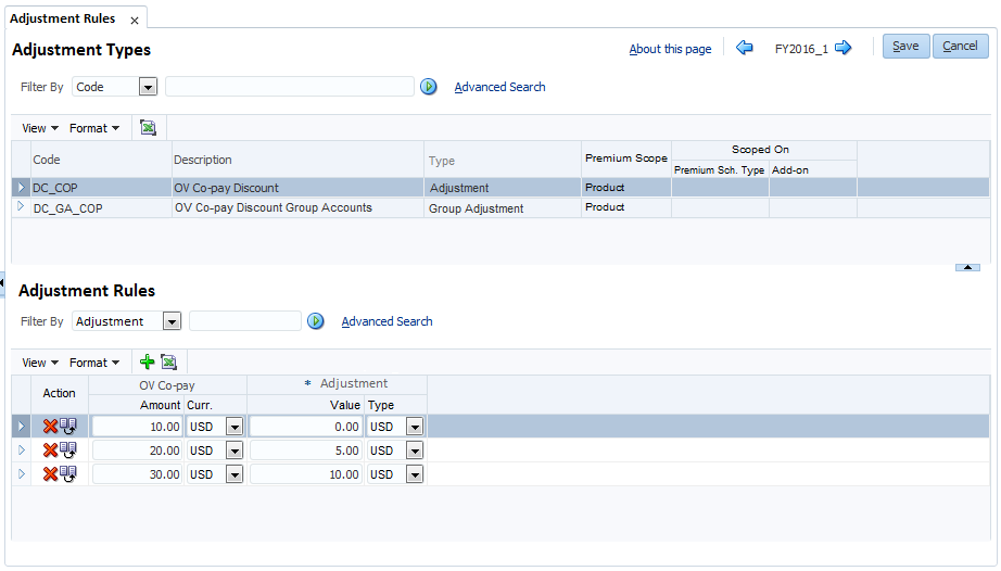

In the Adjustment Rules page Configuration> Premium and Fees> Adjustment Rules, select the adjustment type and the time period to add adjustment rule.
The mock-up below shows the definition of a Co-pay premium adjustment where the adjustment rule holds the co-pay amount as an additional dimension. Note the time period in the top of the page, showing that the displayed adjustment rules apply for the tme period FY2016_1. Different discount values can apply for this adjustment type in a different time period. You can navigate through the time periods by using the arrows to the Left and the Right of the time period field.
