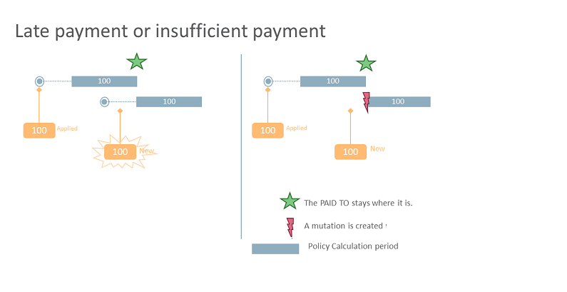

Scenario B: late payment or insufficient payment
In this scenario the registration of amount 100 is received after the pay date of the calculation period. The amount expected for the period is 100 but it is received late. For this scenario, this process will not find any registration on the pay date of the calculation period and therefore the 'Date Paid To' is not updated and a policy mutation of type recalculation with an effective date of payment pay date is created ( as the pay date is earlier compared to the policy calculation period start date). The fact that the payment is late is visible to the process during the premium recalculation process. For details refer to the AU premium calculation specifications.
