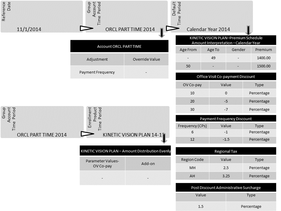

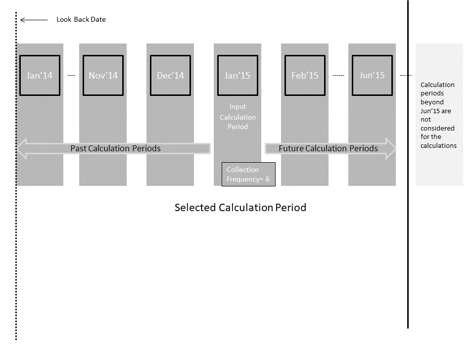

The system selects the calculation periods as mentioned in the image below:
First, the system identifies that the input calculation period Jan'15 consists of three calculation period segments:
11-Jan-2014 - 10-Jan-2015 / Group Account ORCL PART TIME
As part of this calculation period segment, even though the advance collection setting is 12 Months the system identifies that this is the last calculation period and hence no future calculation periods are selected. This is because the contract period ends in Jan'15 calculation period. -
11-Jan-2015 - 14-Jan-2015 / Group Account ORCL PART TIME
As part of this calculation period segment, even though the advance collection setting is 12 Months the system identifies that this the last calculation period and hence no future calculation periods are selected. This is because the policy enrollment products ends in Jan'15 calculation period. -
11-Jan-2015 - 10-Jan-2016 / Group Account ORCL FULL TIME
As part of this calculation period segment, system sees that the collection setting is 6 and hence the periods beyond Jun'15 are not selected.
All the calculation period segments which belong to calculation periods before Jan'15 are discarded since they do not require recalculation. So only calculation period segments within calculation periods Jan'15 to Jun'15 are considered.
Calculations for KINETIC VISION PLAN Jan'15
For the Kinetic Vision Plan product, the system generates two calculation results since it is part of two contract periods. The image below specifies the configuration that is applicable for the first two segments within the calculation period Jan'15.
Calculation for Contract Period 1 / Group Account ORCL PART TIME / Enrollment Product KINETIC VISION PLAN
Enrollment Product Premium
The enrollment product premium is based on the person’s age. In this example the person’s age is 28 years, therefore the applicable premium value is 1400. This is the value for a calendar year. The system considers 1400.00 as the applicable value for a period of 365 days starting from first day of the contract period. The system considers 365 days for the calendar year because the calendar year (2014) of the reference date has 365 days. The policy enrollment product starts 4 days after the contract period start date, therefore the system calculates the premium for only for 361 days.
The amount distribution setting on the enrollment product is Evenly.

Surcharges
The Regional Tax surcharge of 3.25% is applied.

In this scenario both enrollment product adjustment rules and group adjustment rules apply. They have the same input amount: the base premium.
Enrollment Product Adjustment
An Office Visit Co-payment Discount is configured for enrollment product KINETIC VISION PLAN. The Office Visit Co-payment Discount is based on OV Copay parameter based schedule dimension. An OV Co-pay parameter value of 30 is defined on the policy enrollment product in this scenario. Thus the adjustment rule with the dimension value 30 gets selected.
Office Visit Co-payment Discount adjustment = -7 % on a input amount of 1400.00

Group Account Product Adjustment
A Payment Frequency Discount applies for product KINETIC VISION PLAN in group account ORCL PART TIME. The discount depends on the Advance Collection setting on the policy. The system evaluates the following adjustment rules:
| Payment Frequency | Adjustment | Type |
6 |
-1 |
12 |
-1.5 |
By using the dynamic logic condition the rule with the dimension value of 12 gets selected and the adjustment value of -1.5%, gets applied.
Payment Frequency Discount adjustment = -1.5% on an input amount of 1400.00
