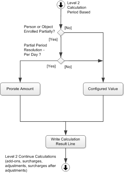

The calculation logic for determining the amount is as described in the image below:
| Circumstances | Calculations |
Full Enrollment |
Configured Value |
Partial Enrollment - Partial Period Resolution Full Charge |
Configured Value |
Partial Enrollment - Partial Period Resolution Per Day |
Configured Value * # Enrolled Days/# Calculation Period Days |
Partial Enrollment - Partial Period Resolution No Charge |
No calculations |
The first step is to determine whether the policy enrollment is full or partial. For this, the system takes into account the overlap in time validity of the policy enrollment with the calculation period.
In case of the enrollment product premium, adjustment and surcharge calculations, the system checks if the policy enrollment product is fully or partially enrolled for the calculation period. Fully enrolled implies that the policy enrollment product is present for all the days in the calculation period for the calculation period segment in context.
In case of the add-on premium, the system checks if the policy add-on is fully or partially enrolled over the calculation period. This is because the add-ons have their own time validity.
The calculation for policy enrollment products that are only effective during part of the calculation period can be handled one of three ways.
Which way, depends on a setting on the enrollment product record.
No Charge means zero premium amount is charged for partial periods. In this scenario the calculation for the policy enrollment product is complete, as there is no premium to calculate.
Full Charge means the premium is calculated as if the person or object was enrolled on the product for the full calculation period to which the calculation period segment in context belongs. The premium calculation continues with this assumption.
Per Day means the system charges premium (and surcharges, and adjustments) only for the days that the person or object is enrolled. The system reduces the calculation results based on the number of days the person or object was enrolled, divided by the number of days over which the premium amount applies.
Enrolled Days Threshold means that Full Charge is applied if the enrolled days threshold is met and that No Charge is applied if the enrolled days threshold is not met.
The system charges the configured value if the person or object is 'fully enrolled'. Otherwise, it checks for the partial period resolution setting on the enrollment product. The configured value gets charged for the calculation period segment if the partial period resolution is 'Full Charge' otherwise the configured value is reduced by a prorate factor for the number of days the person or objects is enrolled for but if the partial period resolution is set to 'No Charge' then the calculation process for the calculation period segment ends. The prorating factor is the number of days the person or object is enrolled divided by the number of days in the calculation period segment.

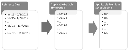

Example 2 - Policy without a Contract
If the premium configurations are the same as in the above example, then the following premium calculations for the person or object on a policy without a contract period hold true:
| Calculation Period | Premium Amount | Calculation |
Jan'15 |
90.32 |
100*(28/31) |
Feb'15 |
100 |
Premium Value for Default Time Period - 2015-1 |
June'15 |
100 |
July'15 |
120 |
Premium Value for Default Time Period - 2015-2 |
Oct'15 |
120 |
Nov'15 |
48 |
120*(12/30) |
The change in the charged amount from the calculation period July'15 onwards is because the setting on the calculation periods determines the reference date. In this example, every calculation period has its start date as the reference date and this date is considered as the reference date for evaluation of the configuration.
The premium calculation for the calculation period July'15 selects the default time period as 2015-2 and, therefore, the charged premium amount is 120.00.
Similarly, the applicable premium amounts for the calculation periods of Aug'15 up to Nov'15 is 120.00. The premium for Nov'15 is prorated to 120*(12/30).
