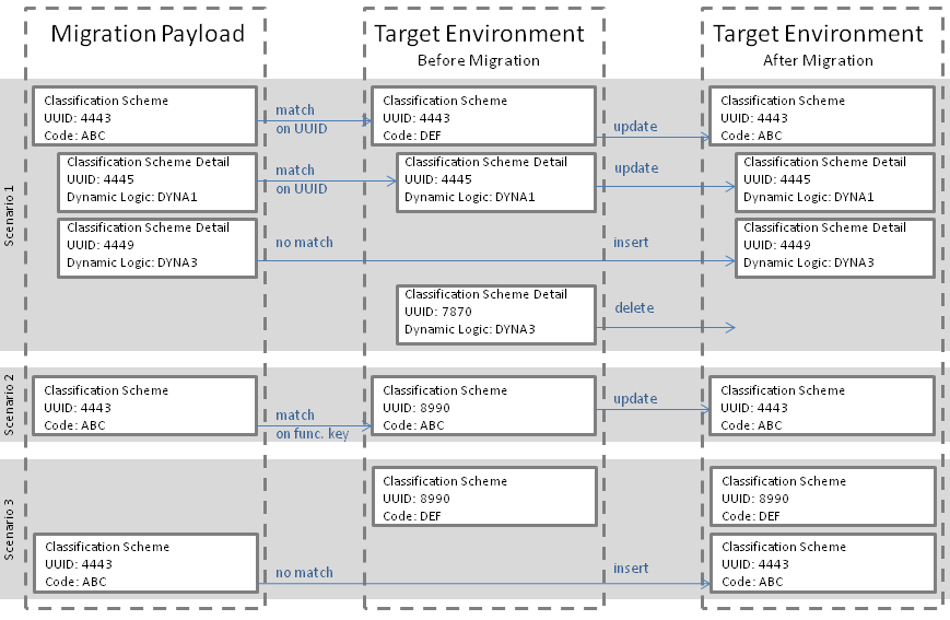

Migration Behavior
The migration function creates, updates and deletes configuration. To do this, the migration function has to recognize the same configuration item across environments. Finding the existing counterpart of a configuration item in the migration payload is referred to as matching.
Matching top level items is a two-pass process. The first pass attempts to attach the universally unique identifier (UUID) of the item in the migration set to an existing item on the target environment. The UUID is a system generated key, that is assigned to each configuration item upon creation, unless created through a migration. If the item is created through a migration the UUID of the item in the migration payload is adopted. This ensures that the UUID for the same configuration item is the same across all environments, as long as the migration function is the only means of creating new configuration items on target environments. If the function succeeds in finding an existing configuration item with the same UUID, then that item is updated or deleted.
If the UUID match fails, the second pass attempts to match on a functional key, that is, a user defined key. For most configuration items the "Code" field is the functional key. This means that if the item in the migration payload has the same code as an item in target environment then it is considered a match. Some configuration items have a more elaborate functional key because they do not have a code, for example, Assigned premium schedule. For these items the secondary match is based on a combination of functional attributes.
Creating a Migration Set
The reason for the two-pass approach is that neither UUID matching, nor functional key is foolproof; matching on UUID breaks in the scenario where the configuration is already existent on the target environment (through means other than migration), matching on the functional key breaks when a key field is updated on the source environment. The combination of both leverages the merits of both patterns; robustness against updates of key fields and the ability to identify the same configuration items across environments.
Some functional keys comprise language dependent fields. The functional keys in the migration set are the keys in context of the default language on the source environment. Upon import, language dependent functional keys are interpreted in context of the default language of the target environment.
If neither the UUID nor the functional key matches, the migration function inserts the configuration item on the target environment. If either match succeeds, then all functional attributes of the existing item are updated with the value provided in the migration payload. Any existing detail matched with a detail in the migration set is updated. Any existing detail not matched is deleted. Details in the migration payload that do not exist on the target environment are inserted.
Because details are matched on the UUID alone, updates to the details that have not been created by a prior migration follow a replacement pattern (that is as opposed to an 'update' pattern). This is illustrated in scenario 1; the premium schedule line with an amount of $ 110.00 has been keyed in on both the source and target environment.
If an item (top level or detail) is matched on the functional key then the existing item adopts the UUID in the migration payload.

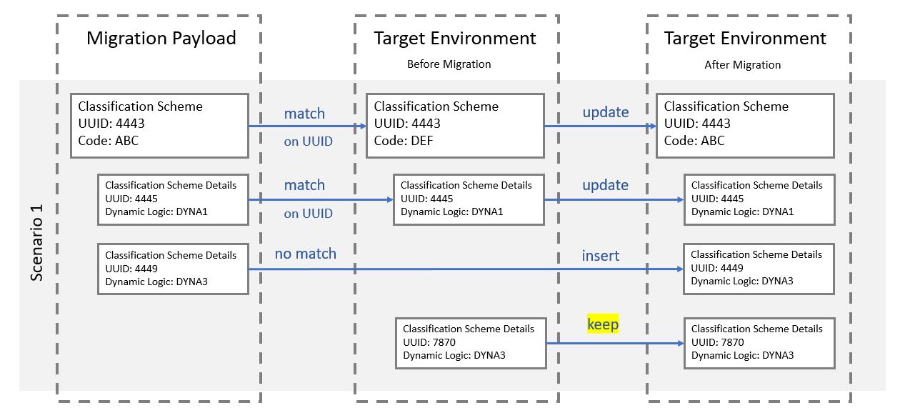

Switching Off Delete by Omission
The ‘delete by omission’ behavior is enabled by default. The user can override this behavior either when creating a new migration set in the source environment or when importing a migration set in the target environment. This behavior applies across all entities in the migration set; either all dependent items are deleted by omission or none of them are.
If the user overrides the behavior upon generation of the migration set, then the payload is marked so that the target system knows not to delete by omission. If the user specifies the desired delete behavior upon importing a migration set, then the import ignores whatever instructions are included in the payload.
Migration behavior without Delete by Omission
To clarify this feature, consider the image above. The default system behavior removes item 7870 but if the user disables the ‘delete by omission’ feature then item 7870 remains unaffected.
