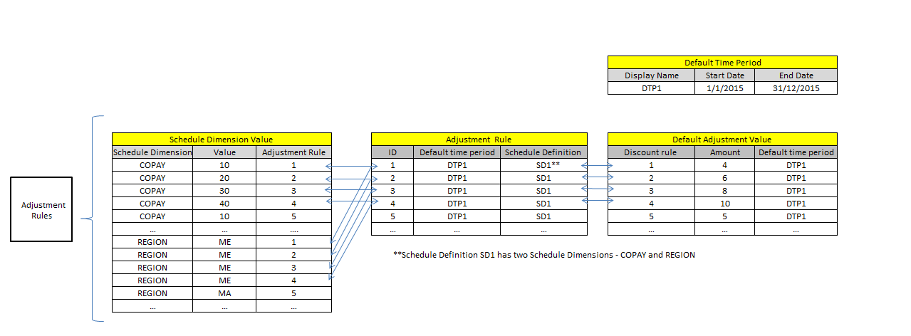

The adjustment rule and the surcharge rule are both referred to as an Adjustment Rule at the entity level. The adjustment value and surcharge value both point to the Adjustment Value.
Adjustment Rules
The adjustment rules are configured within the default time period by defining dimension values and default adjustment values for the scheduledefinition. The adjustment rule couples an adjustment value to the combination of the values of the schedule dimensions (one or more dimension as defined by schedule definition). It points to the adjustment value on one side and the applicable schedule dimension values on the other side. A unique adjustment rule is added for the combination of the values of the schedule dimensions, pointing to an adjustment value.

Schedule Dimension Value
A schedule dimension value stores the value of the configured schedule dimensions. It has the following fields:
| Field | Description |
Schedule Dimension |
The schedule dimension to which the value belongs to |
Value From |
The schedule dimension value from (if the dimension is of type Value, then this will store the exact value) |
Value From Currency |
The currency of the dimension from amount |
Value To |
The schedule dimension value to (this only applies to schedule dimensions with usage Range) |
Value To Currency |
The currency of the dimension to amount |
Premium Schedule Line |
The reference to a premium schedule line |
Adjustment Rule |
The reference to an adjustment rule |
Fee Schedule Line |
The reference to a fee schedule line |
