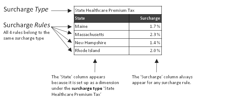

A schedule definition specifies which columns (called dimensions) appear for its surcharge rules.
It also connects the values in those columns to the values on the person or object or the policy, so that the application knows how to evaluate the surcharge rules during the premium calculation.
For the example in the image above, that means connecting (comparing) the state on the surcharge rule to the state of the insured person’s current living address.

In the surcharge page, the user has to select one of the available surcharge types and time periods, before he or she can add a new surcharge rule. The columns that are available on a surcharge rule depend on the schedule definition, that is, surcharge type, on which the rule is based. A surcharge rule has a default column that specifies the actual surcharge value. The presence of any other column depends on the surcharge type:

Note that in the mock-up below the State of Residence field is configured as an additional dimension.

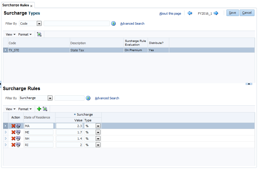

Now that the schedule definition has been created, a new surcharge type has become available in the surcharge page. The next step is to set up surcharge rules the new type.

The surcharge rule configuration is now complete. All surcharge rules are evaluated by default for any calculation.
