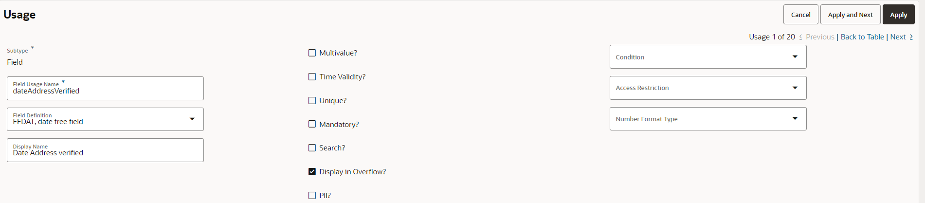

Adding Dynamic Fields and Records
A dynamic field usage is the link between a table (entity) and the configured dynamic field that extends that table. Not all tables can be extended.
Some tables that can be extended, can only be extended sometimes have limitations to the type of fields that can be extended with. For example, whether they could be time valid and whether the table supports details. A dynamic field usage has the following attributes:

Depending on the sub-type, a dynamic field usage refers to either a field definition, a code definition or a record definition.
Only usages for fields can be configured as unique. A dynamic field usage of the type Field cannot be both unique and have multiple values. The unique indicator can no longer be checked once actual values have been stored for that usage.

Examples
Example 1
A customer wants to extend the relation table with a field that captures the Body Mass Index (BMI). The first step is to create a field. The field represents a data type, in this case a number.
The user creates a new field with the code 'bodyMassIndex'. The description is a 'Number and two decimal points', data type is 'num' and maximum length is '5'.
The user creates a new dynamic field usage for the relation table. The name is 'bodyMassIndex' and the display name is 'BMI'. The customer sets the display sequence to 1, meaning that in the standard pages for persons, this is the first dynamic field listed in the designated section. The free field 'C05 is referenced'.
The value of the BMI field is not unique, has only a single value, is not (conditionally) mandatory and is not time valid. There is no condition on whether a value is allowed. There are no time constraints. The result of our setup is that the Relation page displays a new field, labeled 'BMI' that can contain up to 5 characters.
