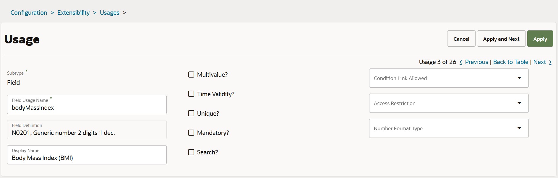

A customer wants to extend the relation table with a field that captures the Body Mass Index (BMI). The first step is to create a field. The field represents a data type, in this case a number.
The user creates a new field with the code 'bodyMassIndex'. The description is a 'Number and two decimal points', data type is 'num' and maximum length is '5'.
The user creates a new dynamic field usage for the relation table. The name is 'bodyMassIndex' and the display name is 'BMI'. The customer sets the display sequence to 1, meaning that in the standard pages for persons, this is the first dynamic field listed in the designated section. The free field 'C05 is referenced'.
The value of the BMI field is not unique, has only a single value, is not (conditionally) mandatory and is not time valid. There is no condition on whether a value is allowed. There are no time constraints. The result of our setup is that the Relation page displays a new field, labeled 'BMI' that can contain up to 5 characters.
