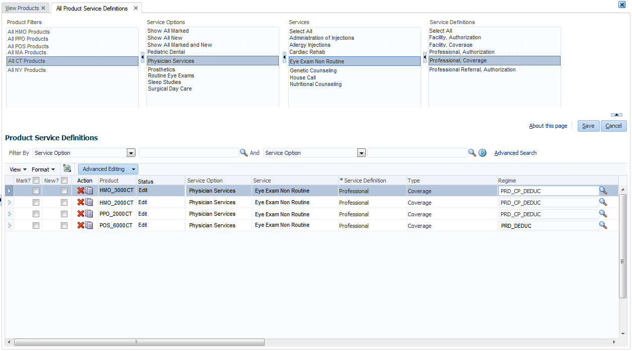

Product Service Definition Filters
From left to right the following filters are displayed:
  • Product Filters; limits the results to all products in the selected filter
  • Service Options; limits the results to all product service definitions that underlie the selected service option or to one of the "Show All" options
    • Show All Marked; displays all product service definitions that have the "Marked?" indicator set to true
    • Show All New; displays all product service definitions that have the "New?" indicator set to true
    • Show All Marked and New; displays all product service definitions that have the "Marked?" and "New?" indicators set to true.
  • Services; limits the results to all product service definitions that underlie the selected service. The "Select All" option encompasses all services displayed in the filter
  • Service Definitions; limits the results to all product service definitions defined for the selected service definition. The "Select All" option encompasses all service definitions displayed in the filter
The filter functionality is used in combination with the quick and advanced search. One value must be selected in each of the filters, in addition extra conditions can be entered in the quick or advanced search. The standard "search" icon will start a search using the criteria entered in the filter and the search.
Selecting an option in one of the filters automatically refreshes the options in the other filters so that it is only possible to create logical combinations. For example, if the "Show All Marked" option is selected in the service options filter, both the services and service definitions filters only display the "Select All" option.

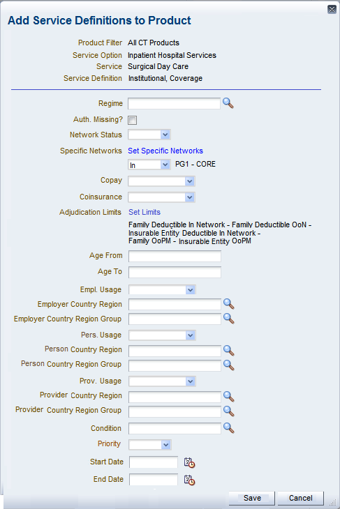

Add Service Definitions to Product
Product service definitions cannot be created with the "+" icon, this is only possible with the advanced editing feature "Add Service Definitions to Product". This feature works in a different way than the Setup Product page. First, this feature is only available when a service definition is selected in the "Service Definitions" filter and a product filter is selected that contains at least 1 product. Second, it will add the selected service definition to all the products in the product filter.
The "Add Service Definitions to Product" feature will not immediately create product service definitions, it displays a detail dialog that allows the user to fully configure all the attributes first. The following fields can be entered:
  • Regime (mandatory)
  • Auth. (Authorization) Missing? If the service definition is of type coverage this indicator is mandatory (unchecked by default)
  • Network Status (mandatory). Are the product provider groups in or out of scope (or either)?
  • Specific Networks. Consisting of two parts. A list of provider groups (including assignment labels) that are connected specifically to the product service definition and the scope of these groups (are they in of out of scope for the product service definition). Configured with the "Set Specific Networks" link which displays the "Specific Networks" dialog.
  • Multiple parameter columns for the situations where it is possible to select a parameter alias for a cover withhold category or limit. Examples covering these situations are explained in Product Configuration Examples
    • When a limit has the indication "Display in UI" and the limit is selected as an adjudication limit for the product service definition
    • When a cover withhold category is indicated as such, by setting its type and a regime is selected containing the cover withhold category as a parameter
  • Adjudication Stop Limits. A list of the stop limits that apply to the product service definition. Configured with the "Set Limits" link, this displays the "Edit Accumulation Options" dialog.
  • Adjudication Continue Limits. A list of the continue limits that apply to the product service definition. Configured with the "Set Limits" link, this displays the "Edit Accumulation Options" dialog.
  • Gender
  • Age From
  • Age To
  • Empl. (Employer) Usage. Is the specified county region (or group) in or out of scope.
  • Employer Country Region
  • Employer Country Region Group
  • Pers. (Person) Usage. Is the specified county region (or group) in or out of scope.
  • Person Country Region
  • Person Country Region Group
  • Prov. (Provider) Usage. Is the specified county region (or group) in or out of scope.
  • Provider Country Region
  • Provider Country Region Group
  • Condition
  • Priority
  • Start Date (mandatory)
  • End Date
Any dynamic fields defined for the product service definition appear in the page.
