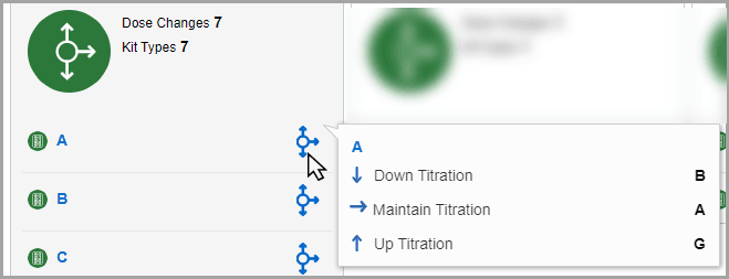

Figure 10-1 Doses in a kit type titration
Next up, you must add the titration to the visit schedule and decide when subjects can titrate. For step-by-step instructions, see Specify when subjects can titrate.
