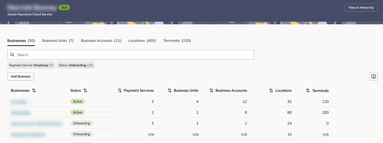

The Business Management page shows all the businesses that exist in your organization, though your view of the businesses depends on your permissions. The following image shows the Business Management page.
Business Status helps you identify businesses that need attention. When action is required as part of the Know Your Customer (KYC) review process, the status is updated in the business list, tab navigation, and Business details page.

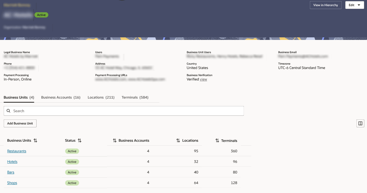

Click a business to see the contact details at the top of the page and a dashboard for business units, business accounts, locations, and terminals below that. See Businesses for more information. The following image shows the business after drilling down from the Business Management page.
You can click on the business unit to drill down and see more details. The business units that are listed show statuses including active, suspended, and closed. If the user is not an owner of the business unit, but has some permissions tied to it (for example they have permissions for the payment location that falls under the business unit), they see a limited view with just the name and status. See Business Units for more information.
