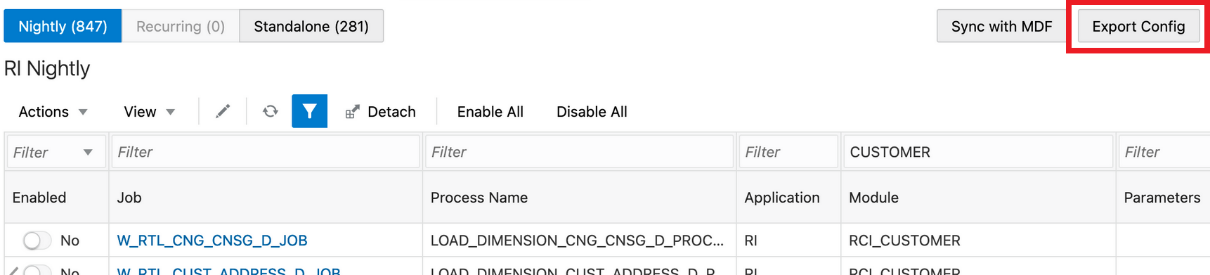

Batch Flow Details
POM allows you to export the full batch schedule configuration to a spreadsheet for review. This is an easier way to see all of the jobs, processes, and dependencies that exist across all batch schedules that you are working with on the platform. Perform the following steps to access batch configuration details:
From Retail Home, click the link to navigate to POM, or go to the POM URL directly if known. Log in as a batch administrator user.
Navigate to the Batch Administration screen.
Select the desired application tile, and then select the schedule type from the nightly, recurring, or standalone options.

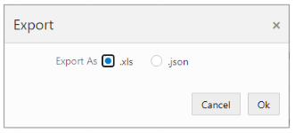

Click the Export Config button to download the schedule data.
Choose your preferred format (XLS or JSON).
XLS is meant for reviewing it visually.
JSON is used for importing the schedule to another environment.
Save the file to disk and open it to review the contents.
