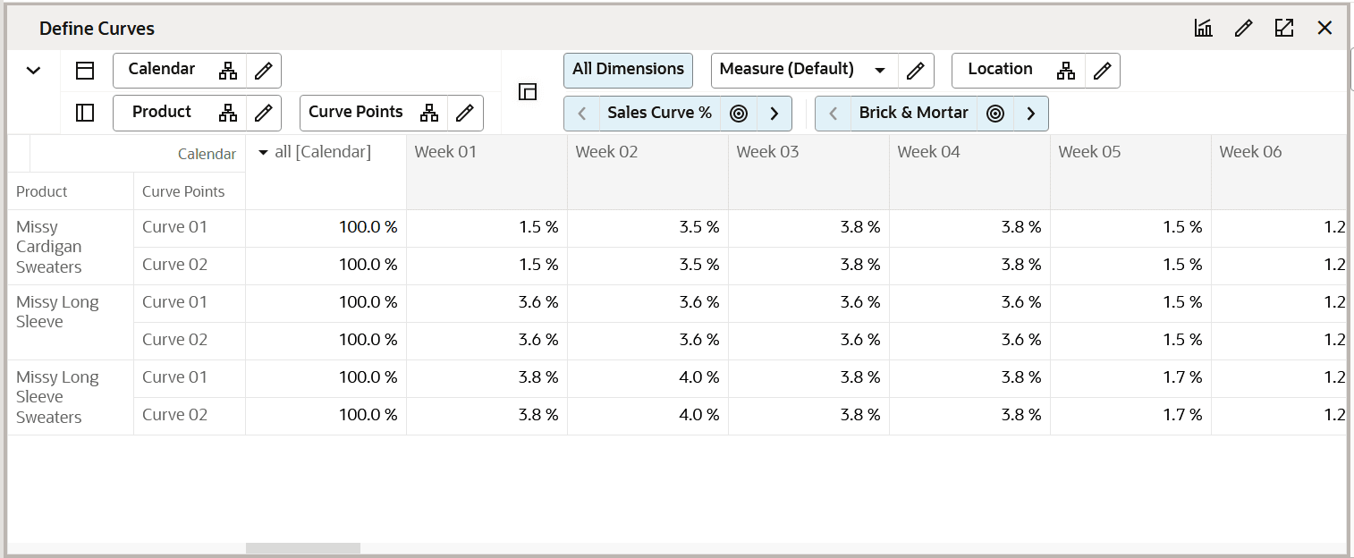

Define Curves View
The Define Curves view is used to view and modify the seeded curve data. Note that all curves will systematically normalize to equal 100%. You have the option of directly entering curves as well. When entering directly, the recommended curve type is Relative.
The steps to complete this process:
  • Review each of the defined curves and determine if adjustments should be made.
  • It can be helpful to view the curves in graph form to see the shape of the curve in a visual format.
  • In the Define Curves view, you are presented with week01 to week53. These are all generic weeks. Do not mistake it for Fiscal Year weeks. These are relative weeks to the assortment period selected by you. For example, you can have an assortment period from week13 to week24. In Define Curves, it will map week01 to week13 of the assortment period (and onwards).
Figure 7-1 Define Curves View
Define Curves View
