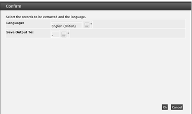

Extracting Suppliers
To extract Suppliers:
Open a list view of Suppliers.
Use the Advanced Search facility to filter the contents to the suppliers you wish to extract.
Select the Extract Data action. The Confirm Data Extract dialog box appears.
Figure 8-1 Confirm Data Extract Dialog Box
Click the icon to select a language for which locale-dependent fields are to appear in the extract file. The default is your locale/language. This is a mandatory field.
Click the icon to select a report output folder where the generated data file is to be saved.
To continue with the extract, click Ok. To return to the list view, click Cancel.
A submission confirmation message box is shown. Click Ok to return to the Suppliers list view.

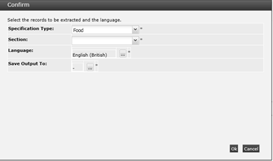

Extracting Product Specifications
To extract Product Specifications or Produce Product Specifications:
Open a list view of Specifications or Produce Specifications.
Use the Advanced Search facility to filter the contents to the specifications you wish to extract.
Select the Extract Data action. The Confirm Specification Data Extract dialog box appears.
Figure 8-2 Confirm Specifications Data Extract Dialog Box
Select the specification type. If no specifications of the selected type appear in the list view, the extract file will be empty. This field is omitted if extracting Produce specifications, otherwise it is mandatory.
Select which section's data is to be extracted. The options are filtered based on the selected Specification Type. If no specifications of the selected type that appear in the list view contain the selected section type, the extract file will be empty. The field is mandatory.
To continue with the extract, click Ok. To return to the Confirm dialog box, click Cancel.
A submission confirmation message box is shown. Click Cancel to return to the Specifications list view.
A Product Specification Data Extract batch job is submitted to create the extract file. On completion, you will receive an email notification with a link to the file in the Data Extracts area of the Report Outputs (see Viewing Extract Files).
In the event of the maximum file size being exceeded, the extract file will truncated at the end of the last complete record and a final row output, reading: FILE TRUNCATED - SIZE LIMIT EXCEEDED. In this case, the file name will be prefixed: * INCOMPLETE.

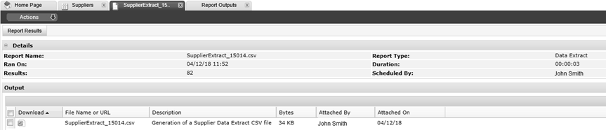

The generated data files are stored as Report Output records in a similar way as report and KPI outputs. See Viewing Report Outputs.
To access the Data Extract files, select the Report Outputs option in the Reports navigation menu.
The extract files are located in the Data Extracts area, as a library of folders. The folder is specified when the extract is submitted.
Locate an extract file by navigating through the folder hierarchy, or using the search box. The columns can be sorted in ascending or descending sequence. The Report Name column shows the name of the extract file.
To see the details for an extract, double-click the row. A tab opens with the details. You can also open the actual file clicking the icon in the Open column, then choosing to open or save the file.
Report Output Details Tab
Figure 8-3 Data Extract Report Output Details Page
Table 8-1 Data Extract Report Output Details Page
| Details | Description |
Report Name |
The name of the generated data extract CSV file. |
Report Type |
This will show as Data Extract. |
Ran On |
The date and time the extract ran. |
Duration |
The length of time it took to generate the file. |
Results |
The number of records in the file. |
Scheduled By |
The name of the user who scheduled the extract. |
Output |
A list of the actual extract files, held as attachments, with columns showing an icon of the file format, the file name, the report description, the size of the file in bytes, the name of the user who scheduled the extract, and the date it was created. |
Click the icon in the Download column to view the extract, then choose to open or save the file.

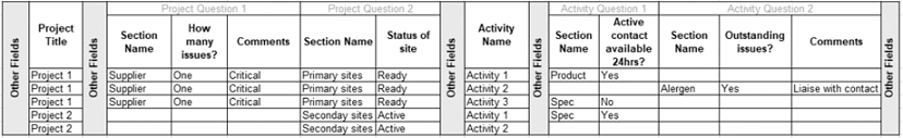

Process & Activity Brief Extracts
A data extract of Process and Activity Brief data can be scheduled as a report, utilizing pre-configured criteria for filtering Processes, Activities, and their Brief questions.
The Process & Activity Brief Extracts glossary is used to configure reusable data extract criteria. When scheduling the report, setting the report type as a Process & Activity Brief Extract allows for the extract criteria to be selected.
The extract is created as a spreadsheet, containing columns that represent data from the Process and Activity records, and their Brief questions and answers, as defined by the extract criteria. The generated extract is output to a Process & Activity Brief Extracts folder in the Report Outputs library. The user is emailed a link to the report output on completion.
A less comprehensive version of the Brief Extract is available for selection from the Processes and Activities list views. The output is also placed in the Process & Activity Brief Extracts folder in the Report Outputs library, and a link to the report output is emailed to the user on completion. Section Name is not visible in the Brief Extract confirmation step as it is not available to select as a list view field, however it is included in the generated output.

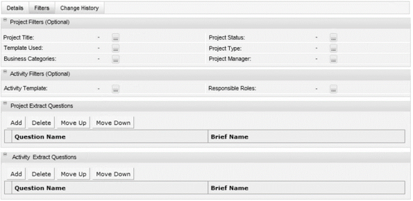

Maintaining the Extract Criteria

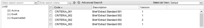

An Extract Criteria glossary is used to maintain a library of reusable extract criteria for applying filters to the Brief Extract reports, by optionally selecting Processes, Activities, and questions from the associated Process and Activity Briefs and current Brief template glossary records.
To access the Extract Criteria, select the Manage Process & Activity Brief Extracts option in the Reporting Admin area. This is only accessible to users with the Advanced Reporting Administrator authority profile.
Figure 8-4 Extract Criteria Page
To see the details for a specific extract criteria, double-click the row. A tab opens with the details. You can also select the View or Edit actions.

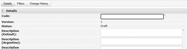

To create a new extract criteria:
Select the New action. The New Extract Criteria page appears.
Figure 8-5 New Extract Criteria Page
Enter the details.
Table 8-2 New Extract Criteria Page
Details Description Code
Enter a unique uppercase code for this extract criteria. Mandatory field.
Version
The version will default to 1. Read-only field.
Status
This will default to Draft. Read-only field.
Description
Enter the description for this extract criteria in the supported languages. The description for the default language is mandatory.
Optionally add any filters to be applied to the extract criteria. See Filters.
Save the changes and exit.

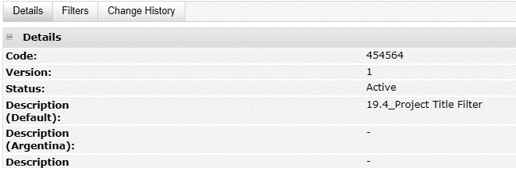

Editing an Extract Criteria
To edit an extract criteria, select the extract criteria on the Extract Criteria page and then select the Edit action. The extract criteria record opens in edit mode in a new tab.
Extract Criteria are maintained as a versioned glossary. When the extract criteria is created, it is assigned version 1 and the status will be Draft. At this status, the code, version, and status may not be edited.
Figure 8-6 Extract Criteria Details

Filters
Use the Filters page to define the extract criteria to be applied as the filter when generating the Brief Extract report.
Figure 8-7 Extract Criteria Details - Filters
To add a filter to an extract criteria:
Open the extract criteria in edit mode and navigate to the Filters page.
Add a row to the Questions tables and click Add.
Enter the details.
Table 8-3 Filters
Details Description Process Filters
Optionally choose any specific Processes to be included in the extract by selecting any combination of Process Titles, Process Status, Process Templates, Process Types, Business Categories, and Process Managers.
If none are selected, all will be included (subject to other filters).
Activity Filters
Optionally choose any specific Activities to be included in the extract by selecting any combination of Activity Templates and Responsible Roles.
Process Extract Questions
When adding a row to the Process Extract Questions table, a list of Process Briefs is presented for the selection of their questions.
Activity Extract Questions
When adding a row to the Activity Extract Questions table, a list of Activity Briefs is presented for the selection of their questions.
Save the changes and exit. If no Process or Activity questions have been selected, validation will show a warning message.

View the generated report in the Report Outputs library.
The Process & Activity Brief Extract reports are output to a Process & Activity Brief Extracts folder in the Report Outputs library. Custom sub-folders may be created within this area, per the other report output types.
The Report Output record shows the extract criteria filters that were applied to generate the report.
Process & Activity Brief Extract File Contents
The Process & Activity Brief Extract report is created as an Excel XLSX spreadsheet.
The column headings are configurable system text, allowing for customization.
The generated report contains all Processes and Activities, and the Brief questions and answers for the required extract criteria. Processes are included based on the Process filters, regardless of the Activity filters; the Activity filters determine which Activities (if any) are included.
Briefs are associated to Processes and Activities through their respective Template glossary records. Process Templates can have multiple Briefs linked to them, but Activity Templates only allow a single Brief.
The following provides a guide to the extract layout.
Figure 8-9 Process & Activity Brief Extract Layout
Table 8-4 Process & Activity Brief Extract Layout
