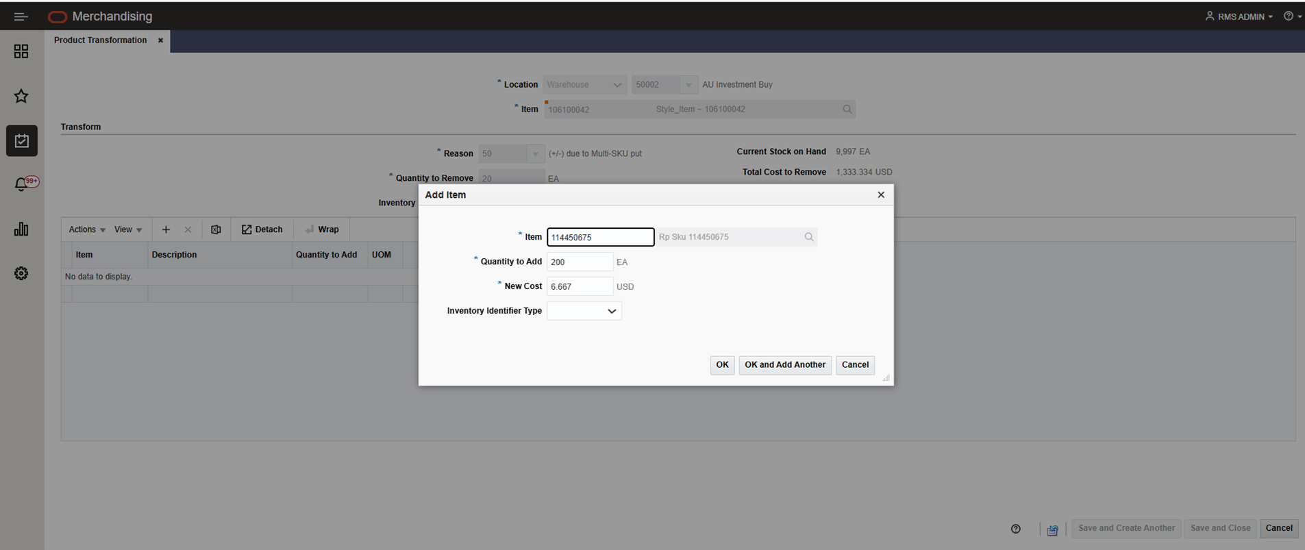

Product Transformation
The Product Transformation page allows you to manually adjust the inventory of a transformed item and the items derived from the transformed item.
For example, a grocer might buy and place into inventory a side of beef. The butcher may prepare steaks and ground beef from the side of beef. In this example, the grocer reduces inventory by one side of beef and increases inventory by the number of steaks and packages of ground beef. In addition to adjusting the quantities, you can adjust the cost of the items derived from the transformed item. The overall cost of the transaction, however, must remain the same.

Add Items for the Product Transformation
Add Items for Product Transformation
In the table you must add the items that you will create from the transformed item.
Once added, the items and their attributes appear in the table. The Total Cost in the Summary Row will be updated. The Total Cost to Remove must equal the Total Cost to Add before an adjustment can be made. Therefore, you can adjust the Quantity to Add and the New Cost columns directly in the table.
To add items you want to create from the transformed item, follow the steps.
  1. From the Actions menu after entering the required details, click Add or click the Add icon. The Add Item page appears.
  2. In the Item field, enter, select or search for the item you want to create. This field is a required field.
  3. In the Quantity to Add field, enter the quantity for the item. This field is a required field.
  4. In the New Cost field displays the current costs of the item. Edit the costs, if necessary. This field is a required field.
  5. In the Inventory Identifier field, select inventory identifier type from the list as applicable and provide a value for the inventory identifier. This field only displays if Inventory Layer Tracking is enabled in System Options.
  6. Then choose one of the following options.
    • Click OK to create the item and add it to the table and close the pop-up.
    • Click OK and Add Another to create additional items.
    • Click Cancel to reject all entries and close the pop-up.
