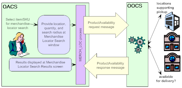

Overview: A typical process of inquiring on locations where an item is available for pickup, as well as whether the item is available for shipment from a location, is described below.
A customer wants to know if an item/SKU is available for pickup at a nearby store or available for shipment from a store location. You select the item/SKU for merchandise locator inquiry. This option is available in order entry, order maintenance, and at the Display Item Availability Screen.
You advance to the Merchandise Locator Search Window (Searching for an Item), where you provide or confirm the customer’s geographic location, the requested quantity of the item, and the radius to search within (for example, search all stores within 25 miles of the customer’s home).
Order Orchestration supports merchandise locator searches only in the U.S. and Canada. -
In the background, the MERCH_LOC process:
Generates the ProductAvailability request message and sends it to Order Orchestration. Order Orchestration checks the availability of the item in stores that stock the item/SKU within the search area, as well as whether the item is available for shipment at any store locations within the same search area.
Receives the ProductAvailability response returned by Order Orchestration. This message lists:
the item/SKU’s current or estimated availability in each searched location that stocks the item for pickup
an indicator of whether the requested quantity of the item/SKU is available for shipment within the search area
You advance to the Merchandise Locator Search Results Screen, displaying the item/SKU’s availability for pickup in each of the locations, including information on any open purchase orders. The screen also indicates whether the requested quantity of the item/SKU is available for delivery from a store within the same search area.
