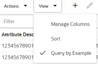

How to use the View options in Modern View
The View options drop-down is available in Modern View screens to control the columns displayed on each screen, the default sort, and how scanning works for individual columns.
Illustrates the View options available in Modern View screens.
This drop-down provides the following options:
  • Manage Columns: Select this option to open a window where you can select the individual columns to display on the screen, or click X to remove a column. When you click X for a column, it moves to the right, where it is available for re-selection. All columns are selected by default.
    After making any changes, you can select Reset to Defaults to restore any columns you have removed. To restore an individual column that you have removed, select Add for that column.
    Click OK to apply your changes, or click Cancel to restore the defaults.
  • Sort: Select this option to open a window where you can select any of the displayed columns and indicate whether to sort in Ascending or Descending order.
  • Query by Example: The query by example option is selected by default, and enables you to enter search criteria above each of the columns in order to filter the displayed records to those matching your criteria. Optionally, you can deselect Query by Example to remove the blank row above the displayed records and remove the option to enter search criteria.
    See each individual screen for information on how the filtering works for each field, for example, whether to display matches that start with the criteria or are an exact match.
