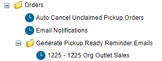

View Active Schedules
Purpose: Use the View Active Schedules screen to:
- Review jobs that are currently scheduled to run, or that have existing history. Only jobs whose Schedule Enabled flag is selected at the Schedule Jobs screen, or that have existing job history that has not been purged, are displayed here.
- Start or reschedule all scheduled jobs and other scheduled programs such as imports, exports, and report generation. You might use the Reschedule All option to resolve an issue with scheduled jobs and programs. You also use this option at initial Order Orchestration configuration to start all jobs and tasks, or after applying an upgrade.
History is retained for the number of days specified in the Job History retention setting at the Tenant-Admin screen.
History icon always shown: The history icon to review job history is available for all jobs listed on this screen, regardless of whether the Schedule Enabled flag at the Schedule Jobs screen is selected for the job. However, history is available for review only if the job has run at least once, and it has any history records that have not been purged.
How to display this screen: Select View Active Schedules from the Systems Menu. The landing page does not have a shortcut to this screen.

Optionally, select a Job Name, Organization, and/or System and click Search to display the scheduled job. Note: Searching by organization or system is supported only for jobs that are specific to an organization or system. See the Job Name field a summary description of each job. |
| select a scheduled job for review |
Highlight a scheduled job to open the Browse Active Schedules window. This window displays the schedule interval and the related time or minutes for the scheduled job. |

Schedule Jobs
Purpose: Use the Schedule Jobs screen to work with scheduled jobs.
Displaying the jobs available to schedule: Use the folders on the left-hand pane to display the related jobs available for scheduling:
Data Hygiene folder: Includes the Completed Order Private Data Purge and the Daily Clean up job.
Exports folder: Includes the Fulfilled Inventory Export, Inventory Quantity Export, and Sales Order Data Extract
jobs. -
Imports folder: Includes the Identity Cloud User Synchronization, Incremental Inventory Import, and Product Import jobs.
Orders folder: Includes the Auto Cancel Unclaimed Pickup Orders job, the Email Notifications Job and the Generate Pickup Ready Reminder Emails Job
Highlight a job in the left-hand pane to display schedule information and options in the right-hand area.
See each job below for more information.
You can use the generate pickup ready reminder emails job to send emails to customers indicating that their pickup orders or ship-for-pickup orders are ready for pickup, based on whether the date and time when they were picked or received is older than the number of Aged Hours defined for the job.
The email will be generated to the customer each time the job runs until the order is picked up or canceled. Emails are not generated for orders that are under review, or that are not assigned to a Store Connect location.
Generate by organization: You need to schedule this job separately for each organization that needs to generate pickup-ready reminder emails. Click the plus sign next to the job name in the left-hand panel to display a list of existing organizations.
The list of organizations is available only if Use Routing Engine is selected at the Tenant-Admin screen. Also, only organizations that have a Store Connect system defined are displayed.Scheduling the Generate Pickup Ready Reminder Emails Job
Click the plus sign next to the Generate Pickup Ready Reminder Emails job in the left-hand panel to display a list of existing organizations.
Click the organization where you want to generate the reminder emails. When you select an organization, the Generate Pickup Ready Reminder Email Fields are displayed to the right.
The list of organizations is available only if Use Routing Engine is selected at the Tenant-Admin screen.-
Optionally, select Schedule Enabled.
Optionally, select Run Now to run the job immediately.
Select each Day of Week when the job should run.
Select the Time when the job should run.
Specify the Aged Hours to indicate how many hours after a pickup order is picked, or a ship-for-pickup order is picked (if the sourcing location is the same as the pickup location) or received (if the sourcing location ships the items to the pickup location), that it is eligible to receive the pickup reminder.
Select Save.
Select Cancel to exit the screen.
