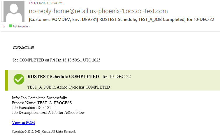

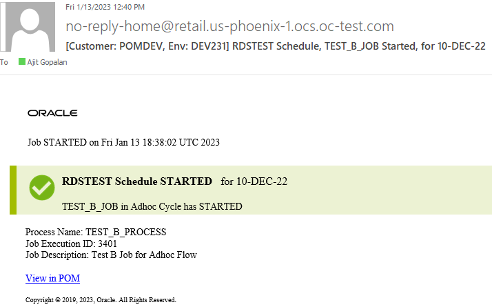

| Start of Job | JobStarted Created when a Job starts. See Job Start Email below. | Job | All |
| Completion of Job | JobCompleted Created when a Job completes successfully. See Job Completion Email below. | Job | All |

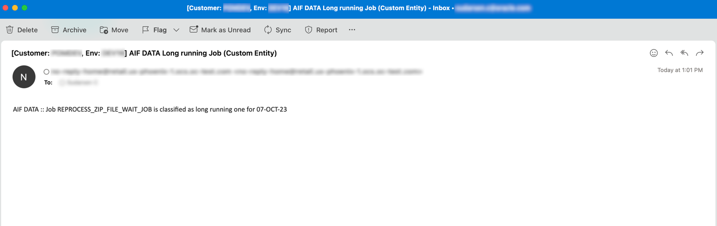

| Job runs for longer than expected | LongRunningJob Created when the Job runs longer than its configured or calculated threshold runtime. For a complete explanation of how a job is deemed long-running, see the Long Running Jobs subsection of the Batch Job subsection of the Batch Schedule section of the Batch Concepts chapter of this document. | Schedule | All |

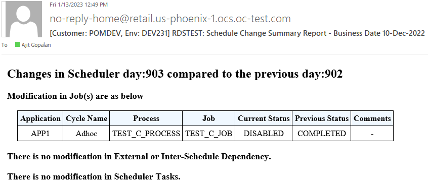

Schedule Change Summary Email
This summary is generated as part of the Scheduler Day creation process. It highlights any differences between the configuration of the previous Scheduler Day and the current. It also highlights differences in scheduling between the Schedule instances. This email has no attachments.

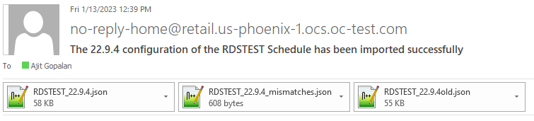

Schedule Config Import Summary Email
This summary is generated once a configuration has been imported successfully into POM using the Import Config button of the Batch Administration screen. This email provides the following attachments
                           Batch Configuration prior to the Import (JSON). This backup can be used to restore the configuration, in case the new configuration is not good enough.
                           The new Batch Configuration.
                           A JSON that highlights the mismatches between the previous and the new configuration.

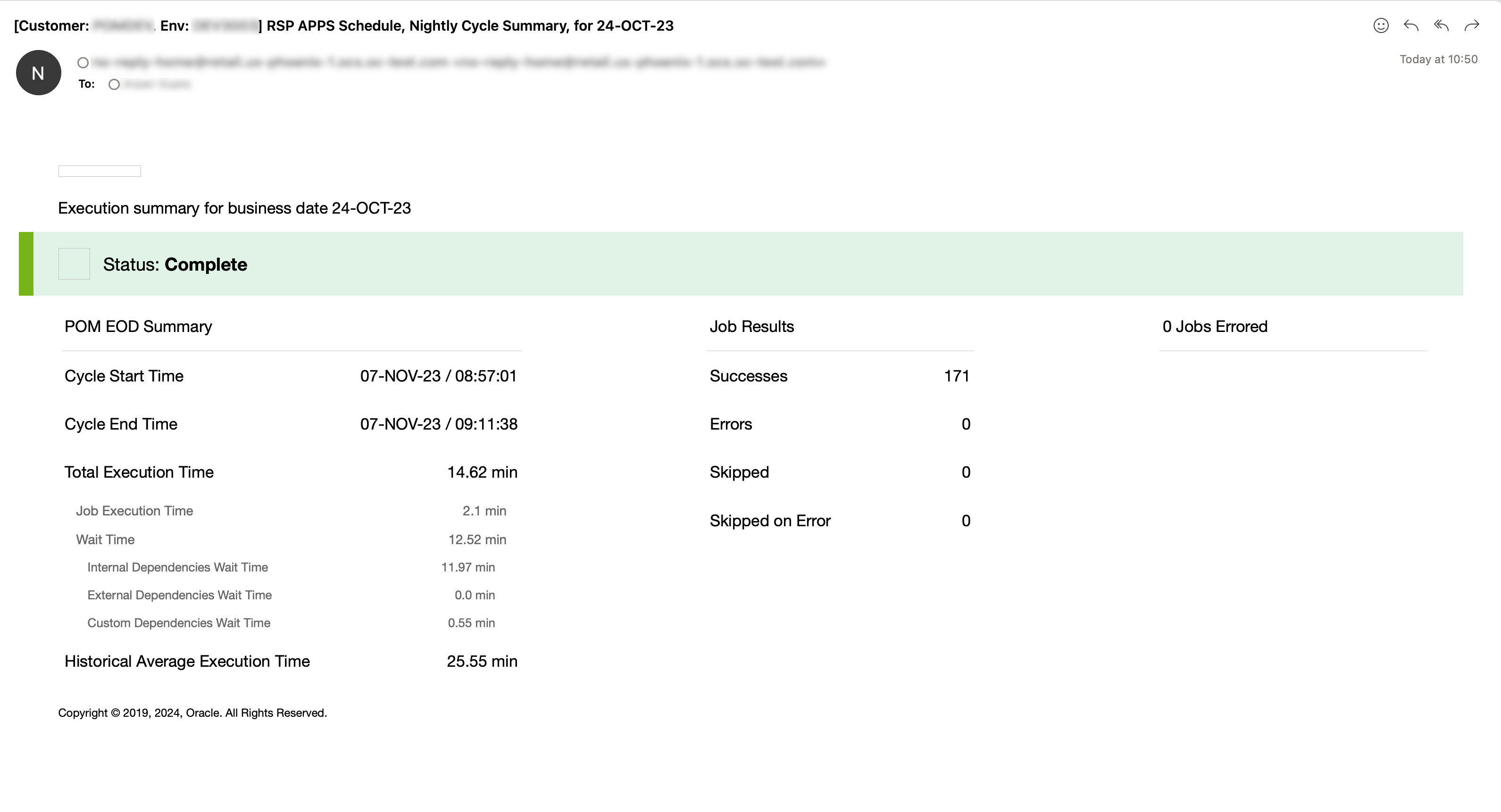

Nightly Summary Email
At the end of the Nightly Cycle, a summary report is created that is sent as an email. This report is sent to email addresses, configured for the NightlySummaryReportExternal and NightlySummaryReport Notification Types. The former Notification Type is meant to be subscribed by Customers, while the latter is for Oracle Internal.
This email also contains two attachments. One is a summarized report (CSV) of all the Job executions of that Nightly cycle. The other attachment contains a summarized report of the Nightly cycle completion times for the last 15 days. The latter attachment is only available to email recipients of the NightlySummaryReport Notification Type.

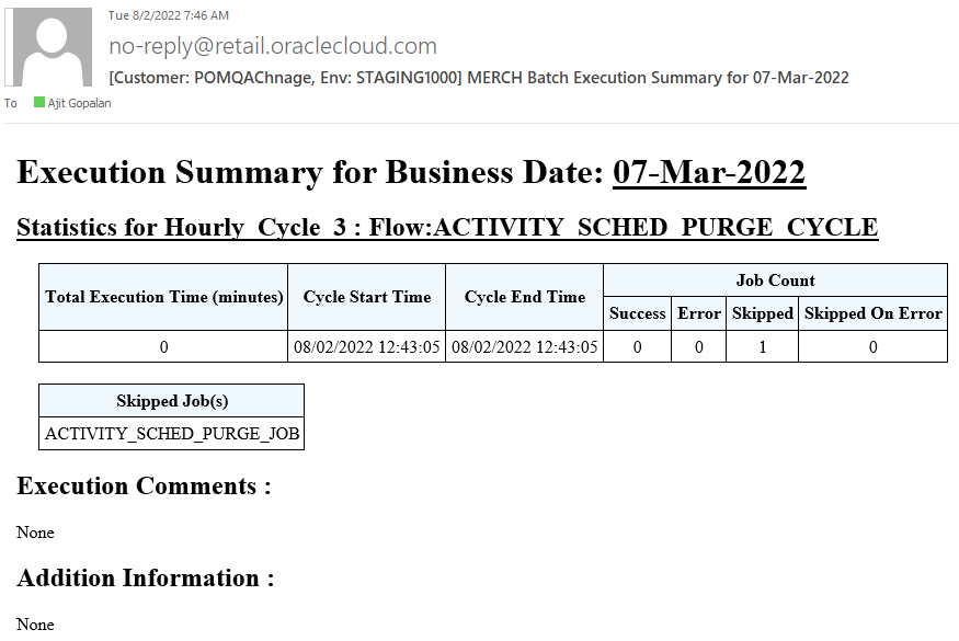

Hourly Flow Summary Email
This email is generated when a Flow on the Hourly Cycle completes successfully. It is sent to the email addresses that subscribed to the Notification Type – IntradayCycleSummaryReport.

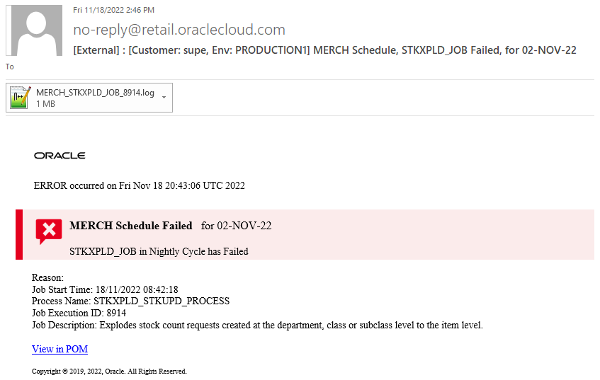

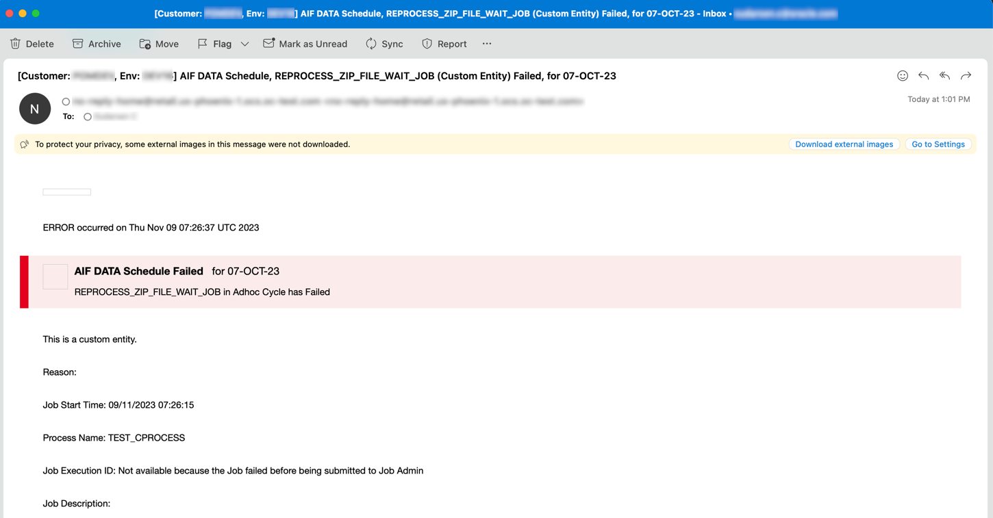

Job Error Email
When a Job fails during execution, a Job Error email is sent. This email will include as an attachment the log file of
the failed Job execution. This email will be generated, even if the skip-on-error flag is set on the Job.
The Job Error email sent to email addresses configured on the ErrorNotification type, will contain the log file attachment, while the email sent to email addresses configured on the ErrorNotificationExternal type will not contain this attachment.
