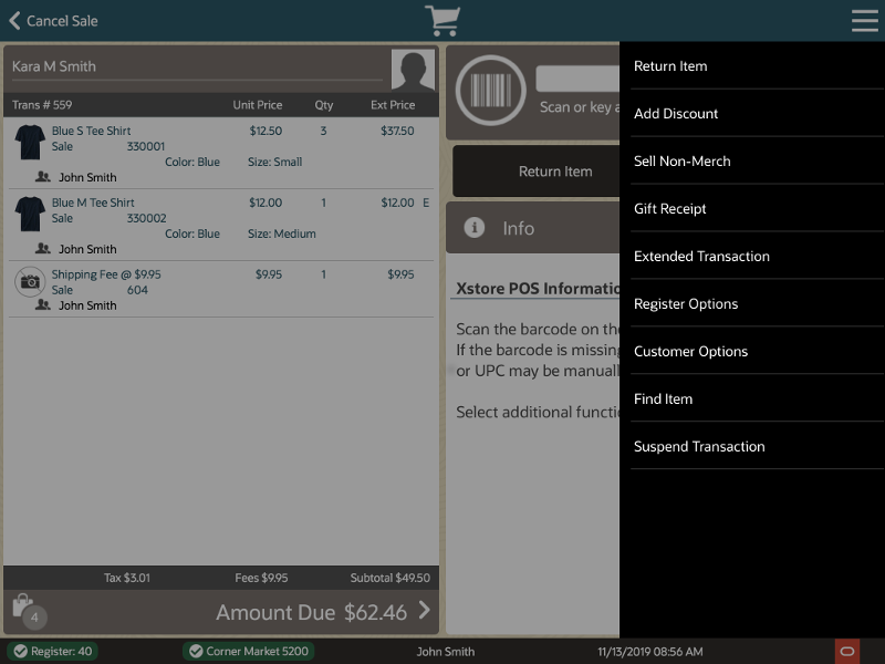

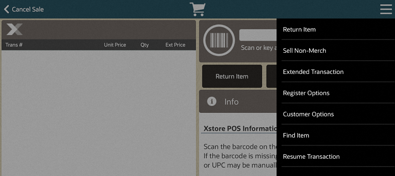

Figure 10-1 Xstore POS Context Menu - Sale Mode

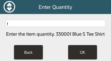

Changing the Item Quantity
To change the quantity of a selected item (see Adjusting an Item):
Select Change Qty. See Figure 10-3.
Figure 10-4 Enter Quantity Prompt
Enter the new quantity for the item.
Select the OK button.
Return to the transaction screen.

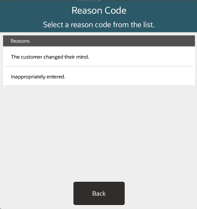

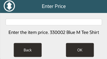

Changing the Item Price
To change the price of a selected item (see Adjusting an Item):
Select Change Price. See Figure 10-3.
Figure 10-5 Enter Price Prompt
Enter the new price for the item.
Select OK.

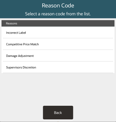

Figure 10-6 Reason Code List
Select the proper reason for the price change.

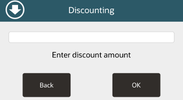

Discount an Item
To add a discount to a selected item (see Adjusting an Item):
Select Add Item Discount. See Figure 10-3.

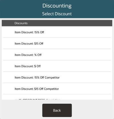

Figure 10-7 Discount List
Select the proper discount.
Figure 10-8 Discount Reason Code List
Select the proper reason for the discount.
If prompted to enter an amount:
Figure 10-9 Discount Amount Prompt
Figure 10-10 Discount Percent Prompt
Enter the discount amount or percentage.
Select OK.

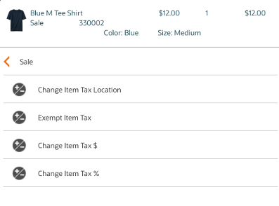

Changing Item Taxes
To change the tax on a selected item (see Adjusting an Item):
Select Change Item Tax. See Figure 10-3.
Figure 10-11 Change Item Tax Menu
Continue with the proper procedure:

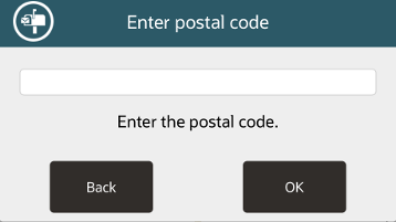

Figure 10-12 Enter Postal Code
Enter the postal/zip code for the new location.
Select OK.
The tax location for the item is changed and Xstore POS returns to the item entry screen.

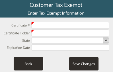

Figure 10-13 Customer Tax Exempt Entry Form
Enter the information about the customer's tax exemption certificate.
Select Save Changes.

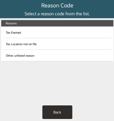

Figure 10-14 Reason Code List
Select the reason for the tax change.
The tax exemption is applied to the item and Xstore POS returns to the item entry screen.

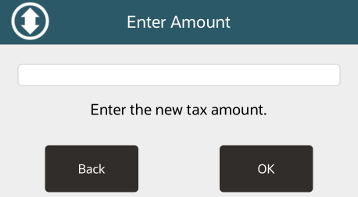

Changing the Item Tax Amount
To change the amount of the item tax:
Select Change Tax $in the Change Item Tax Menu. See Figure 10-11.
Figure 10-15 Enter Tax Amount
Enter new tax amount.
Select OK.
Figure 10-16 Reason Code List
The amount of the tax for the item is changed to the new value and Xstore POS returns to the item entry screen.

Voiding an Item
To void a selected item (see Adjusting an Item):
Select Void Line. See Figure 10-3.
Figure 10-19 Reason Code List
Select the proper reason for voiding the line.

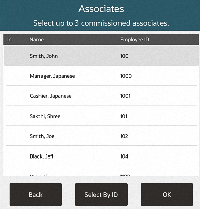

Figure 10-20 Associates List
Select the proper associate(s) in the list.

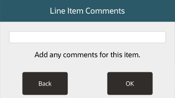

Figure 10-22 Line Item Comments Entry Form
Enter the comment.
Select OK.

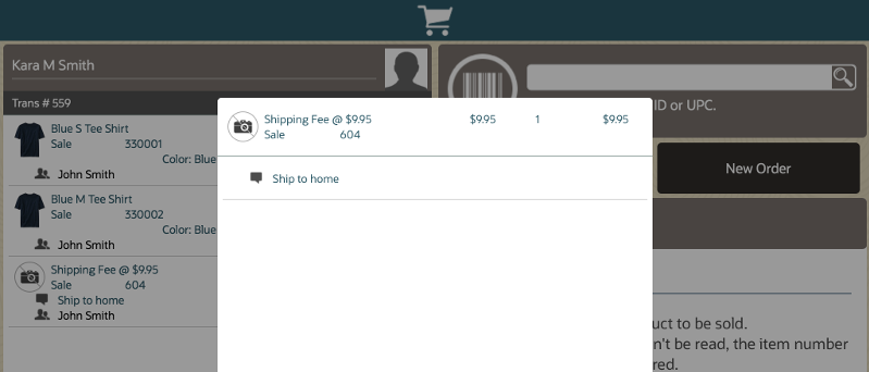

Figure 10-23 Comment List
Select the comment to remove.
The comment is removed and Xstore POS returns to the transaction screen.
Changing Transaction Taxes
This section deals with changing transaction taxes.
To change the tax applied to a transaction:

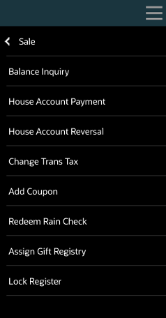

Select Register Options in the Context Menu. See Figure 10-1.
Figure 10-24 Register Options Context Menu
Select Change Trans Tax in the Register Options Menu.
Figure 10-25 Change Trans Tax Menu

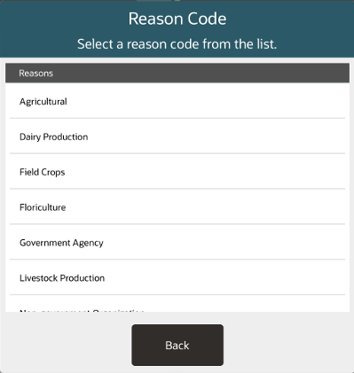

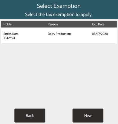

Figure 10-27 Select Tax Exemption
Select the exemption or create a new customer's tax exemption certificate.
Figure 10-28 Select Reason Code
The tax exemption is applied to the transaction and Xstore POS returns to the item entry screen.
Change Transaction Tax Amount
To change the amount of the transaction tax:
Select Change Tax $ in the Change Transaction Tax Menu. See Figure 10-25.
Figure 10-29 Enter Tax Amount
Select OK.
Figure 10-30 Select Reason Code

Suspending/Resuming a Transaction
This section describes how to suspend and resume a transaction.
Suspending a Transaction
To suspend a transaction:
Whilst in a sale, select Suspend Transaction in the Context Menu. See Figure 10-1.
Xstore POS returns to the Main Menu.
A transaction must have no customer assigned and no items added for it to be used for resuming a suspended transaction.
To resume a suspended transaction:
Select Resume Transaction in the Context Menu.
Figure 10-33 Xstore POS Sale Context Menu
Xstore POS opens a list of suspended transactions.
Select the proper transaction to resume.
The transaction resumes. Xstore POS returns to the sale screen.
