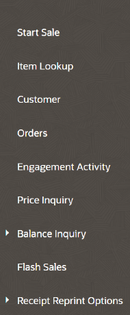

The Xstore POS register is opened and closed through the Till menu on the Main menu. The following procedures describe the method for opening and closing the register. The system may prompt you to open the register after the store has been opened.
Figure 51-1 Main Menu
