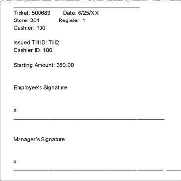

  7. Select OK to close the confirmation prompt. A receipt is also printed for your records.
    Figure 53-5 Till Assigned Receipt
  8. Oracle Retail Xstore POS assigns the till to the cashier and returns to the Till Details screen. The till is now listed as Issued.

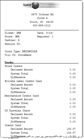

  7. The system records the information, prints a reconcile receipt for your records, and returns to the Till Management menu.
    Figure 53-6 Reconcile Receipt
    Reconcile Receipt
    Deposits from the reconciled till are made to the store safe.
