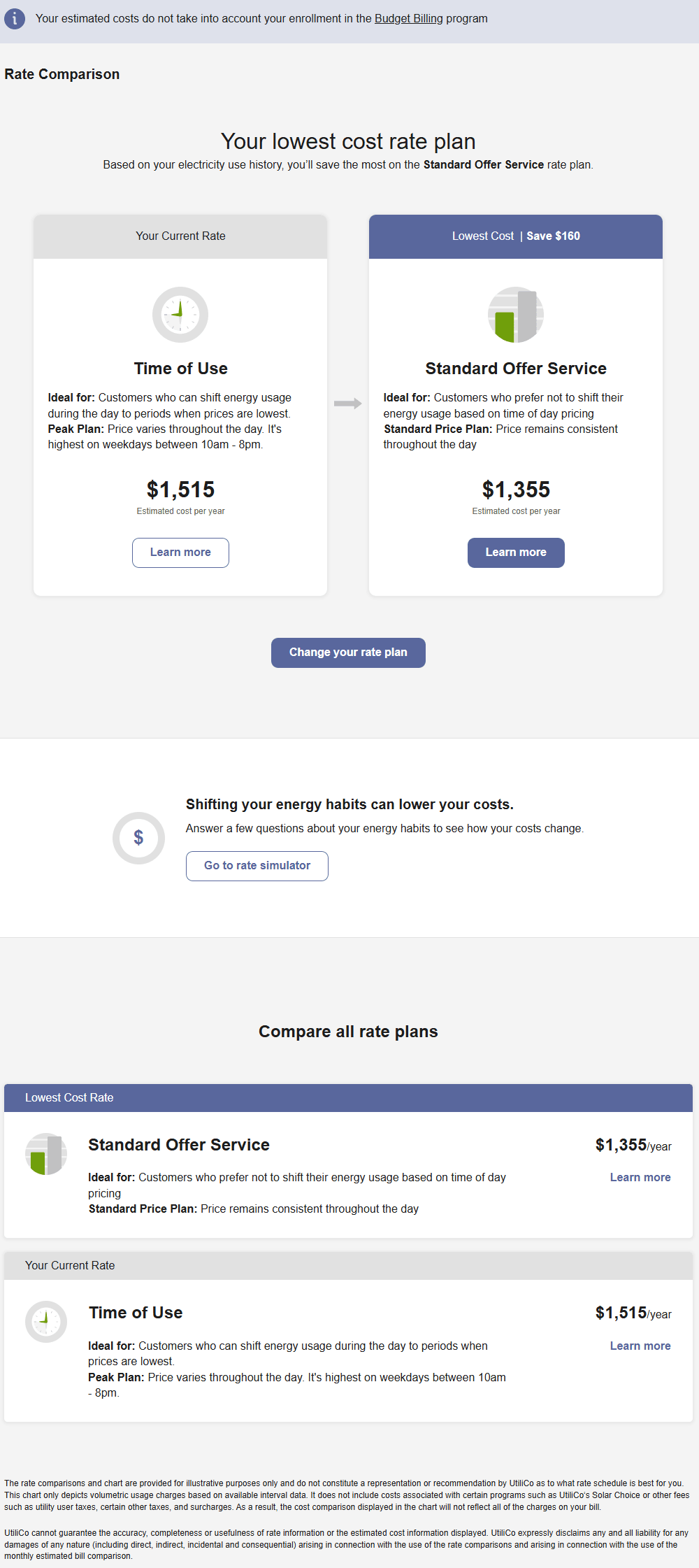

Rate Comparison Widget Configurations
The Rate Comparison widget displays high-level information about a customers rate plan relative to other available rate plans.
This image shows an example of the Rate Comparison widget, which compares a customer's rate plan to other available rate plans.

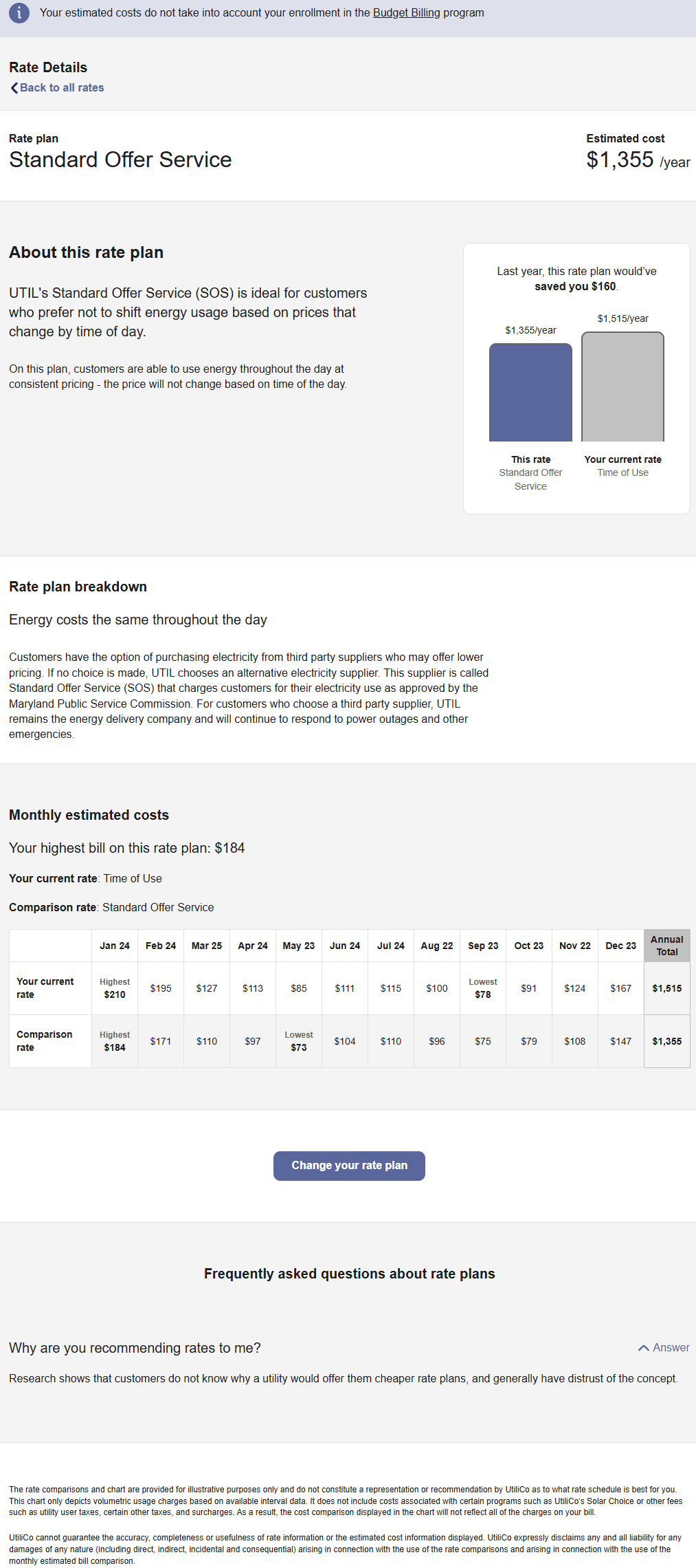

Rate Plan Details Configurations
The Rate Plan Details includes rate titles, descriptions, and other more specific rate plan information to users. This required content must be provided for each rate plan, and thus must be completed for each rate plan. In addition to the required configurations, optional content can also be included for each rate plan. This content is also optional for each rate attribute, which are displayed as part of applicable rate plans.
This image shows an example of the Rate Details Widget, which shows details including cost per year, a description of the plan, and cost estimates.

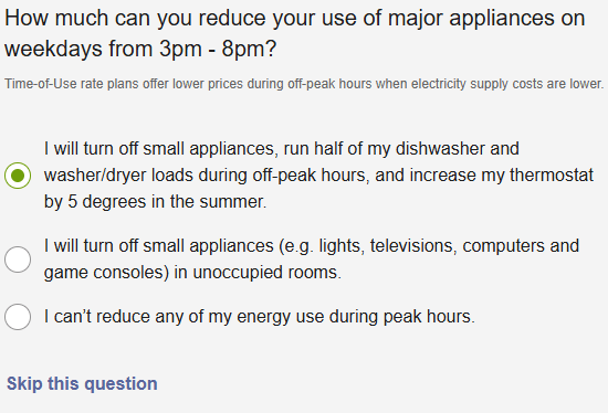

Rate Simulator Configurations
The Rate Simulator prompts customers to answer a few short questions about how they might change their energy use.
This image shows an example of the Rate Simulator, which guides the customer through questions about their energy use to determine the best rate plan for them.
