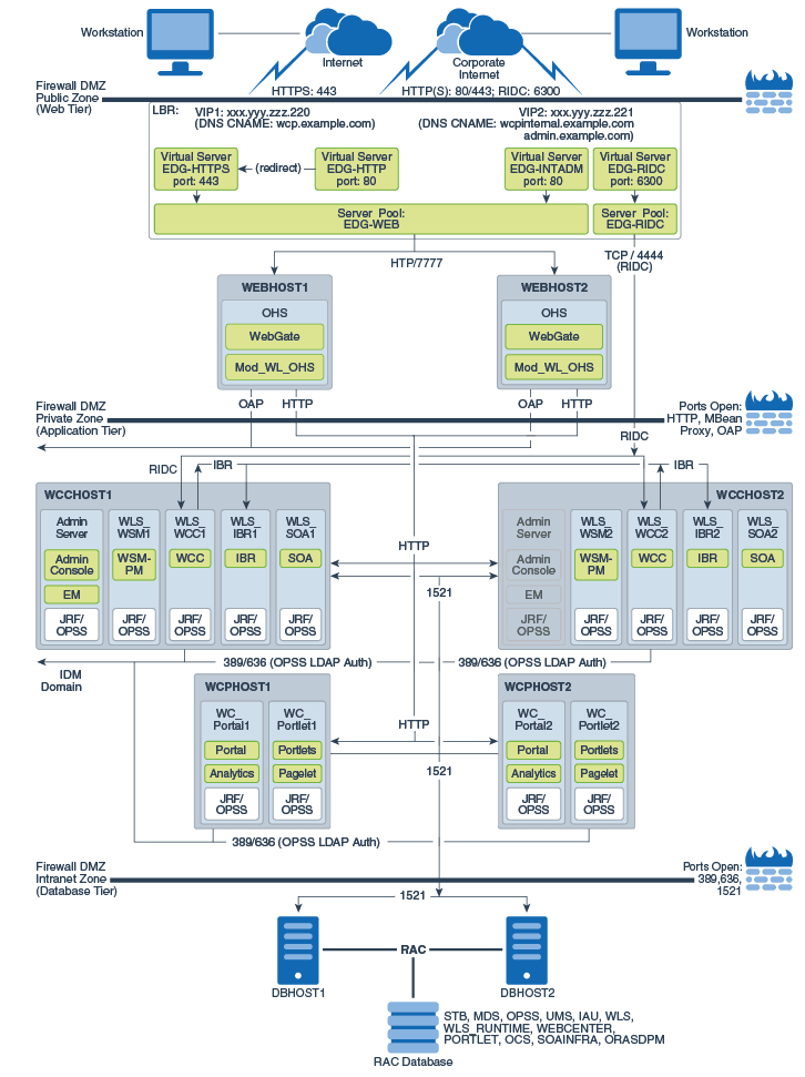

Diagram of the WebCenter Portal Enterprise Deployment Topology
The following diagram shows the primary Oracle WebCenter Portal enterprise deployment topology, which is described in this guide.
Description of the illustration wcedg-wc-portal-topology-diagram.eps

Summary of the WebCenter Portal Load Balancer Virtual Server Names
In order to balance the load on servers and to provide high availability, the hardware load balancer is configured to recognize a set of virtual server names.
For information about the purpose of each of these server names, see Summary of the Typical Load Balancer Virtual Server Names.
The following virtual server names are recognized by the hardware load balancer in Oracle WebCenter Portal topologies:
wcp.example.com
— This virtual server name is used for all incoming end-user client traffic. It acts as the access point for all HTTP traffic to the run-time WebCenter Portal components. The load balancer listens for all requests to this virtual server name over SSL. Optionally, an additional virtual server configured on port 80 can be set up with a rule to automatically redirect all traffic to port443
. As a result, clients access this environment's services using the following secure address:https://wcp.example.com:443
wcpinternal.example.com — This virtual server name is used for internal calls to Oracle WebCenter services. There are two virtual servers configured at the hardware load balancer. One (listening on port 80) is used for web-based services. The second (listening on port 6300) is for WebCenter Conent Remote Intradoc Client (RIDC) API calls.
Incoming traffic from clients is not SSL-enabled. Clients accessing the HTTP services use the following address. These requests are forwarded to port 7777 on WEBHOST1 and WEBHOST2:
http://wcpinternal.example.com:80/
WebCenter Content RIDC-enabled applications, such as the WebCenter Content Desktop Integration Suite (DIS) and WebCenter Portal Document Services, use port 6300 for TCP connections to WebCenter Content Server's RIDC API endpoints. These requests are forwarded to port 4444 on WCCHOST1 and WCCHOST2:
wcpinternal.example.com:6300
admin.example.com
- This virtual server name is for administrators who need to access the Oracle Enterprise Manager Fusion Middleware Control and Oracle WebLogic Remote Console interfaces. As a result, clients access this service by using the following secure address:https://admin.example.com:445

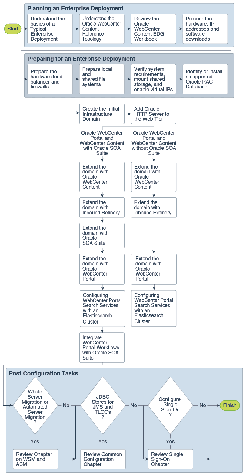

Flow Charts and Roadmaps for Implementing the Primary WebCenter Portal Enterprise Topologies
The following topics summarize the high-level steps you must perform to install and configure the enterprise topology described in this chapter.
Flow Chart of the Steps to Install and Configure the WebCenter Portal Enterprise Topologies
The following flow chart shows the steps required to install and configure the primary enterprise deployment topologies described in this chapter. The sections following the flow chart explain each step in the flow chart.
This guide is designed so you can start with a working WebCenter Portal domain and then later extend the domain to add additional capabilities.
This modular approach to building the topology allows you to make strategic decisions, based on your hardware and software resources, as well as the Oracle WebCenter Portal features that are most important to your organization.
It also allows you to validate and troubleshoot each individual product or component as they are configured.
This does not imply that configuring multiple products in one Configuration Wizard session is not supported; it is possible to group various extensions like the ones presented in this guide in one Configuration Wizard execution. However, the instructions in this guide focus primarily on the modular approach to building an enterprise deployment.
