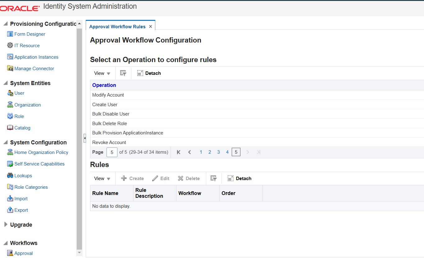

3.2.1 Layout of the Oracle Identity System Administration Interface
The layout of the Oracle Identity System Administration consists of left and right panes, links, and options.
Figure 3-1 shows a sample page and the layout of the interface.
Figure 3-1 Layout of the Oracle Identity System Administration Console
Description of "Figure 3-1 Layout of the Oracle Identity System Administration Console"

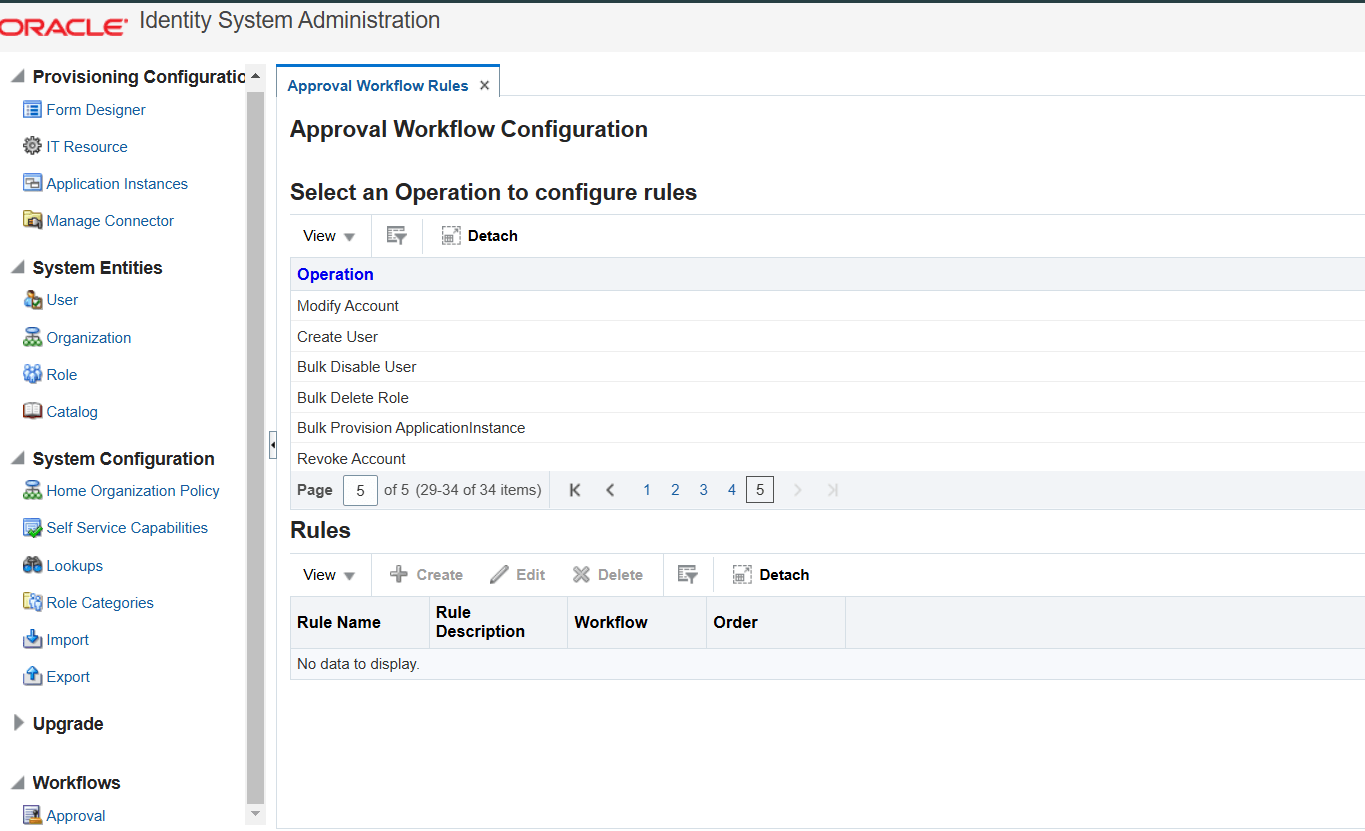

3.2.3.5 About Workflows
The Workflows region consists of the Approval Workflow Rules page.
Use this page to manage approval workflow rules that determine whether or not request approval is required for an operation and which workflow is invoked for a specific operation.
See "Managing Workflows" for more information.

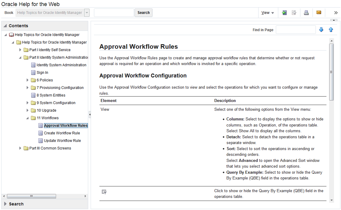

3.2.4 Help in Oracle Identity System Administration
The Oracle Identity System Administration interface includes a help system. Clicking the Help link opens the help system in a new window.
The help interface provides context-sensitive help. For example, if you are in the Form Designer page and click the Help link, then help content related to form designer is displayed.
The default view of the help system consists of three panes:
3.2.4.1 About Top Pane in the Help Interface
The top pane in the Help interface consists of the Book list, search fields, and buttons for navigation and printing.
Figure 3-2 shows a sample page and default layout of the help interface.
The top pane consists of the following:
Book drop-down list: From this drop-down list you can select one of the following values:
Help Topics for Oracle Identity Manager: Select this value to open all help topics for Oracle Identity Manager.
Administrator's Guide for Oracle Identity Manager: Select this value to open the online help version of Oracle Fusion Middleware Administrator's Guide for Oracle Identity Manager.
Developer's Guide for Oracle Identity Manager: Select this value to open the online help version of Oracle Fusion Middleware Developing and Customizing Applications for Oracle Identity Manager.
User's Guide for Oracle Identity Manager: Select this value to open the online help version of Oracle Fusion Middleware Performing Self Service Tasks with Oracle Identity Manager.
Custom Help Topics for Oracle Identity Manager: Select this value to open any custom help topics.
Search field: Specify any word or term to search for in the help system.
View: From the View menu, you can select any one of the following options:
Maximize Reading Pane: Collapses the lower left pane to maximize the reading pane, which is the lower right pane.
Restore Default Window Layout: Restores the current layout of the help system to the default layout.
Contents: Restores the lower left pane to display the Contents region along with the help topics, if it is not already being displayed.
Search: Displays the Search region in the lower left pane. In the Search region, you can search for help topic and the search results are displayed in a tabular format. Here are a few guidelines on performing a search:
Search criterion specified in the Search field can be made case sensitive by selecting the Case Sensitive option.
To define your search precisely, you can specify the boolean operators & (for AND), |(for OR), ! (for NOT) in your search criterion, select the Boolean expression option, and then click Search.
To search for help topics containing all words specified in the search criterion, select All words.
To search for help topics containing any word specified in the search criterion, select Any words.
Show permanent link for this topic page: If you want to save the link to a help topic for future reference, then from the View menu, select Show permanent link for this topic page. In the dialog box that is displayed, right-click the link to the help topic and select one of the following options:
Bookmark This Link: Adds the help topic URL to the browser bookmarks.
Copy Link Location: Copies the help topic URL to the clipboard.
Toolbar: The help system contains a toolbar that provides action buttons for certain tasks. You can view the name of the button by moving the mouse pointer over the button. The following buttons are available:
Go back one page: Takes you back to the page containing the previous help topic.
Go forward one page: This icon is enabled only if you have clicked the Go back one page icon. Clicking the Go forward one page icon takes you to the next page in the sequence of topics you visited.
Print this topic page: Prints the current help topic.
Email this topic page: Drafts an email with a link to the help topic currently displayed in the help system. This draft can be sent to the desired email recipient.
Link to this topic page: Saves the link to a help topic for future reference by right-clicking the link to the help topic in the dialog box that is displayed, and then selecting one of the following options:
3.2.4.2 About Lower Left Pane in the Help Interface
The lower left pane contains the Contents and Search regions. By default, the Contents region is expanded.
The Contents region displays links to help topics depending on the option you select from the Book drop-down list in the top pane. You can click the arrow icon beside Contents to expand or collapse the Contents region.
3.2.4.3 About Lower Right Pane in the Help Interface
The lower right pane is also called the reading pane.
The lower right pane displays any help topic that you search for or open from the Contents and Search regions in the lower left pane. The pages in the reading pane displays a description of each element in the UI page of Oracle Identity System Administration.
