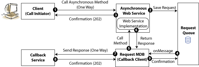

4.1.1 Understanding the Flow of an Asynchronous Web Service Using a Single Request Queue
In an asynchronous web service using a single request queue there is a single message-driven bean (MDB) associated with the request queue that handles both the request and response processing.
Although the single request queue scenario may provide better performance, it is less reliable than the request and response queue scenario. Oracle recommends that you use the request and response queue scenario, described in Understanding the Flow of an Asynchronous Web Service Using a Request and a Response Queue, and not the single request queue scenario.
The following diagram illustrates the flow of an asynchronous web service using a single request queue. In this scenario, there is a single message-driven bean (MDB) associated with the request queue that handles both the request and response processing.
Figure 4-1 Asynchronous Web Service Using a Single Request Queue
Description of "Figure 4-1 Asynchronous Web Service Using a Single Request Queue"
The following steps describe the flow shown in the previous figure:
The client calls an asynchronous method.
The asynchronous web services receives the request and stores it in the request queue.
The asynchronous web service sends a receipt confirmation to the client.
The MDB listener on the request queue receives the message and initiates processing of the request.
The request MDB calls the required method in the web service implementation.
The web service implementation returns the response.
The request MDB, acting as a callback client, returns the response to the callback service.
The callback service returns a receipt confirmation message.
The request MDB returns a confirmation message to the request queue to terminate the process.
In this scenario, if there is a problem connecting to the callback service (in Step 7), then the response will not be sent. If the request is retried later, the flow resumes from Step 4 and the web service implementation will be called again (in Step 5). This may not be desirable depending on your application logic or transactional control processing. In the next scenario, the response is stored in a separate response queue, eliminating the need to recall the web service implementation in the event that the callback service is not available initially.
