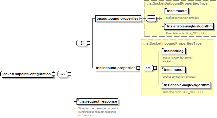

Configuration Properties
Figure 41-2 illustrates the configuration properties for the transport endpoint. These properties are configured in the schema file, SocketTransport.xsd. For the location of this file, see Sample Location and Directory Structure .. This file allows you to extend the basic set of properties defined in the common schema provided with the SDK. Refer to the SocketTransport.xsd file for information on each of the properties.
Tip:
For more information about these configuration properties, see Step 4. Define Transport-Specific Artifacts .
Figure 41-2 SocketEndpointConfiguration Properties
Description of "Figure 41-2 SocketEndpointConfiguration Properties"

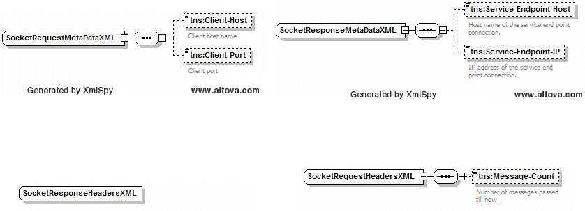

Also in the SocketTransport.xsd file are the request and response header and metadata properties, as illustrated in Figure 41-3. Refer to the SocketTransport.xsd file for more information about these properties.
Figure 41-3 Request and Response Header and Metadata Configurations
Description of "Figure 41-3 Request and Response Header and Metadata Configurations "
