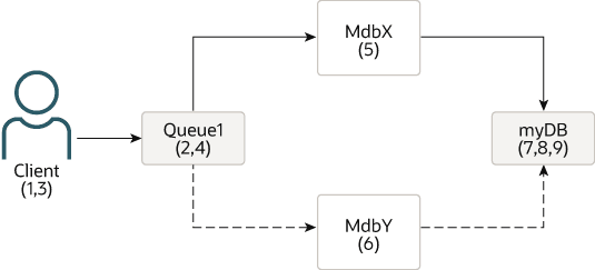

Joe Orders a Book
XYZ Online Bookstore implements a simple processing design that uses JMS to process customer orders. The JMS processing system is composed of:
A message producer sending to a queue (Queue1).
Multiple message driven beans (MDBs), such as MdbX and MdbY, that process messages from Queue1.
A database (myDB) that contains order and order status information.
Joe logs in his XYZ Online Bookstore account and searches his favorite book topics. He chooses a book, proceeds to the checkout, and completes the sales transaction. Then Joe realizes he has previously purchased this same item, so he cancels the order. One week later, the book is delivered to Joe.
What Happened to Joe's Order
In Joe's ordering scenario, his cancel order message was processed before his purchase order message. The result was that Joe received a book he did not wish to purchase. The following steps demonstrate how Joe's order was processed.
The Figure 10-1 and the corresponding actions demonstrate how Joe's order was processed.
Joe clicks the order button from his shopping cart.
The order message (message A) is placed on Queue1.
Joe cancels the order.
The cancel order (message B) is placed on Queue1.
MdbX takes message A from Queue1.
MdbY takes message B from Queue1.
MdbY writes the cancel message to the database. Because there is no corresponding order message, there is no order message to remove from the database.
MdbX writes the order message to the database.
An application responsible for shipping books reads the database, sees the order message, and initiates shipment to Joe's home.

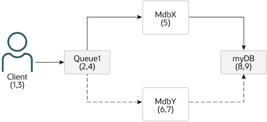

To ensure that all messages in Joe's order are processed correctly, the system administrator for XYZ Bookstore configures a Message Unit-of-Order based on a user session, such that all messages from a user session have a Unit-of-Order name attribute with the value of the session id. See How to Create a Unit-of-Order. All messages created during Joe's user session are processed sequentially in the order they were created because WebLogic Server guarantees that messages in a Unit-of-Order are not processed in parallel.
In Figure 10-2 and the corresponding actions demonstrate how Joe's order was processed using Message Unit-of-Order.
Figure 10-2 Workflow for Joe's Order Using Unit-of-Order
Description of "Figure 10-2 Workflow for Joe's Order Using Unit-of-Order"
Message B on MdbY is blocked until MdbX acknowledges the order message. See What Happens When a Message Is Delayed During Processing?.
Message A is committed and written to the database.
Message B is committed and written to the database.
Because there is a corresponding order message, Joe's order is removed from the database and he does not receive a book.
