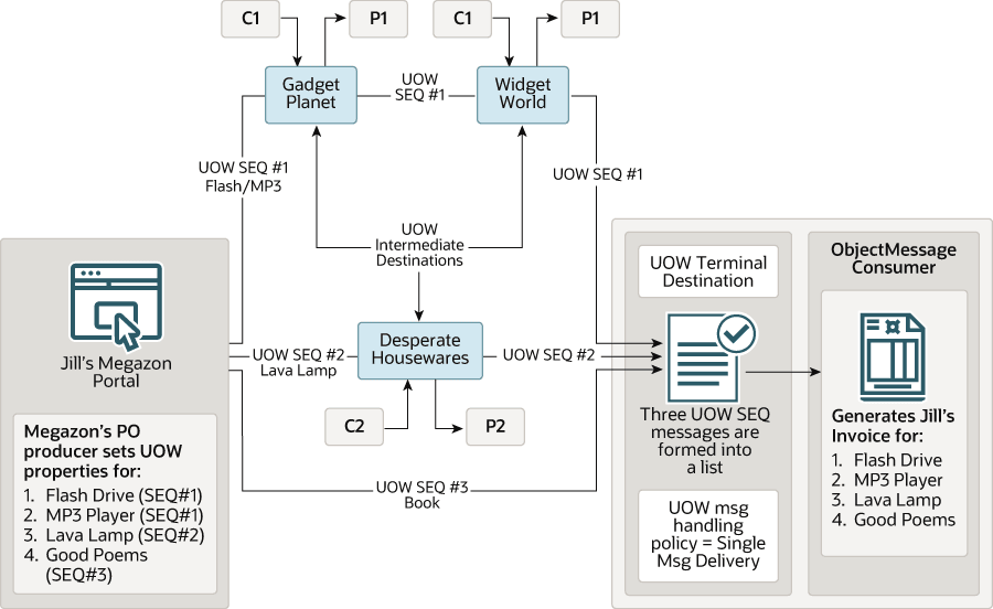

Message Unit-of-Work Case Study
This section provides a simple case study for Message Unit-of-Work based on an online order that requires a variety of merchandise from multiple companies.
Jill Orders Miscellaneous Items from an Online Retailer:
The Megazon online retailer implements a processing design that uses JMS to process customer orders for a variety of merchandise, some of which need to be routed to Megazon's partner companies to complete the order. For example, Megazon can directly fulfill book orders, but must re route some parts of the order for certain electronics or houseware items. Since Megazon is configured to use UOW, items in an order can be routed as UOW messages to these intermediate company destinations before being passed onto Megazon's terminal destination where all the UOW messages that make up the order are gathered before a final invoice can be processed.
The Megazon JMS processing system is composed of:
A UOW producer sending order fulfillment component messages with the required UOW properties to the appropriate intermediate and terminal destinations
Intermediate destinations for non book items, where UOW component messages are processed by consumer and/or producer clients before being passed onto the final UOW destination
A UOW terminal destination where the component messages are gathered for final processing
Jill logs into her Megazon account and does some holiday shopping. She chooses a book, flash drive, MP3 player, and a lava lamp, she then proceeds to the checkout, and completes the sales transaction.
How Message Unit-of-Work Completes the Order:
To ensure that all messages in Jill's order are processed as a single unit, the order-taking JMS producer client sets UOW properties on her order messages to indicate that they are part of a single unit. These UOW message properties must also be copied by any consumer or producer clients listening on the intermediate Gadget Planet, Widget World, and Desperate Housewares destinations before they pass the UOW messages onto the terminal destination. Last, the system administrator for Megazon configures the terminal destination to UOW Message Handling Policy parameter to Single Message Delivery. See How to Create a Unit-of-Work Message Group.
Figure 11-1 and the corresponding actions demonstrate how Jill's order was processed using Message Unit-of-Work.
Figure 11-1 Workflow for Jill's Order Using Unit-of-Work
Description of "Figure 11-1 Workflow for Jill's Order Using Unit-of-Work"
Jill clicks the order button from her shopping cart.
The order is split into three messages that use the same unique UOW name:
SEQ#1, which is routed to the intermediate Gadget Planet queue, where a consumer processes the Flash Drive order before passing SEQ#1 onto a producer who then routes it to the intermediate Widget World queue, where a consumer processes the MP3 player order before passing SEQ#1 to the terminal Megazon queue for final invoice processing.
SEQ#2, which is routed to the intermediate Desperate Housewares queue, where a consumer processes the lava lamp order before passing SEQ#1 onto a producer who routes it to the Megazon terminal processing queue for final invoice processing.
SEQ#3, which is routed directly to Megazon's terminal queue for book order fulfillment and for final invoice processing.
The terminal Megazon queue gathers the three UOW messages before forming them into an
ObjectMessagelist for delivery to Megazon's invoice consumer client. -
Jill receives an invoice that shows her entire order was processed.
