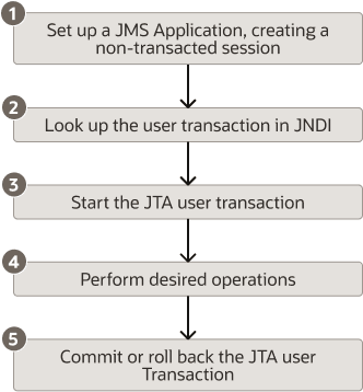

Figure 12-2 shows the steps required to set up and use a JTA user transaction.
Figure 12-2 Setting Up and Using a JTA User Transaction
Description of "Figure 12-2 Setting Up and Using a JTA User Transaction"
Step 1: Set Up JMS Application, Creating Non-Transacted Session
Set up the JMS application as described in Setting Up a JMS Application, however, when creating sessions, as described in Step 3: Create a Session Using the Connection, specify that the session is to be non-transacted by setting the transacted
boolean value to false
For example, the following methods illustrate how to create a non-transacted session for the PTP and Pub/sub messaging models, respectively.
qsession = qcon.createQueueSession( false, Session.AUTO_ACKNOWLEDGE ); tsession = tcon.createTopicSession( false, Session.AUTO_ACKNOWLEDGE );
When a user transaction is active, the acknowledge mode is ignored.
Step 2: Look Up the User Transaction in JNDI
The application uses JNDI to return an object reference to the UserTransaction
object for the WebLogic Server domain.
You can look up the UserTransaction
object by establishing a JNDI context (context
) and executing the following code, for example:
UserTransaction xact = ctx.lookup("jakarta.transaction.UserTransaction");
Step 3: Start the JTA User Transaction
Start the JTA user transaction using the UserTransaction.begin()
method. For example:
xact.begin();
Step 4: Perform Desired Operations
Perform the desired operations associated with the current transaction.
Step 5: Commit or Roll Back the JTA User Transaction
Once you have performed the desired operations, execute one of the following commit()
or rollback()
methods on the UserTransaction
object to commit or roll back the JTA user transaction.
To commit the transaction, execute the following commit()
method:
xact.commit();
The commit()
method causes WebLogic Server to call the Transaction Manager to complete the transaction, and commit all operations performed during the current transaction. The Transaction Manager is responsible for coordinating with the resource managers to update any databases.
To roll back the transaction, execute the following rollback()
method:
xact.rollback();
The rollback()
method causes WebLogic Server to call the Transaction Manager to cancel the transaction, and roll back all operations performed during the current transactions.
Once you call the commit()
or rollback()
method, you can optionally start another transaction by calling xact.begin()
