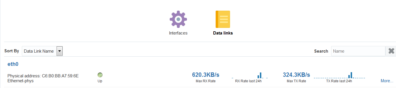

32.6.2 View Information About Datalinks
To see information about datalinks:
  1. Select Targets and then All Targets.
  2. Select Host.
  3. Select a host.
  4. In the summary, click the Network Connectivity tab.
  5. Click the Data links option.
  6. Click the More... option to see the path and the transmission rate.
