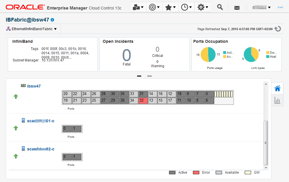

The Fabric dashboard's dashlets include the following information:
VLAN IDs or partition keys for this fabric:
For an Ethernet fabric with tagged VLANs, this section lists each VLAN ID. If there are no tagged VLANs, this section displays Untagged.
For an InfiniBand fabric, this section lists each partition key.
Open Incidents
Ports Occupation
Last Configuration time

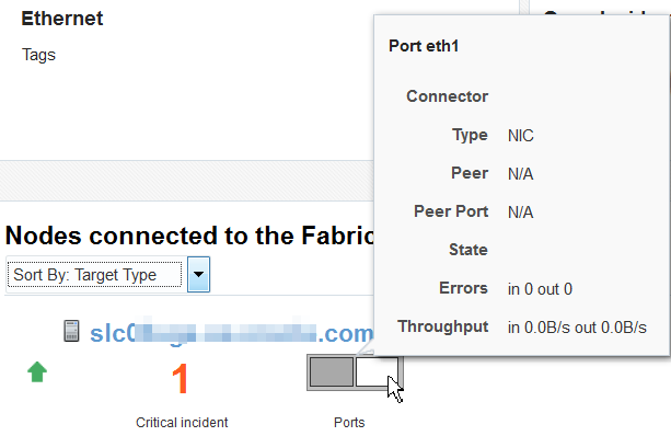

The Connected Nodes section lists every node, or network switch, in the fabric. You can also display specific information by hovering on the node, as show in Figure 32-7.
