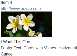

responseItems:
- type: "cards"
  cardLayout: "horizontal"
  footerText: "Footer Text: Cards with Values: Horizontal"
  cards:
  - title: "${myvalues.name}"
    description: "${myvalues.description}"
    imageUrl: "${myvalues.image}"
    cardUrl: "http://www.oracle.com"
    iteratorVariable: "myvalues"
    actions:
    - label: "I Want This One"
      type: "postback"
      payload:
        action: "itemPicked"
        variables:
          user.horizontalVariable: "${myvalues.name}"
globalActions:
  - label: "Cancel"
    type: "postback"
    payload:
      action: "cancel"
  - label: "Send Location"
    type: "location"

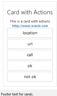

responseItems:
- type: "cards"
  cardLayout: "vertical"
  footerText: "Footer text for cards."
  cards:
  - title: "Card with Actions"
    description: "This is a card with actions"
    actions:
    - label: "share"
      type: "share"
      payload:
        action: "share"
    - label: "location"
      type: "location"
      payload:
        action: "location"
    - label: "url"
      type: "url"
      payload:
        action: "url"
        url: "http://www.oracle.com"
    - label: "call"
      type: "call"
      payload:
        action: "call"
        phoneNumber: "808 888 1212"
    - label: "ok"
      type: "postback"
      payload:
        action: "ok"
        variables:
          user.someVariable: "ok"
    - label: "not ok"
      type: "postback"
      payload:
        action: "notok"
        variables:
          user.someVariable: "not ok"
