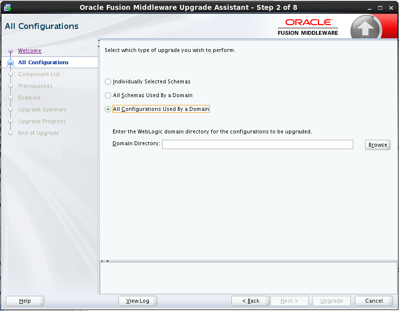

A.1.4 All Configurations Used by a Domain
Select the All Configurations Used by a Domain option to upgrade component configurations for a managed WebLogic Server domain. Click Browse and use the navigation tree to select a valid domain directory. A domain directory contains a config directory, which contains a config.xml file.
all configurations that are used by this domain will be included in the upgrade.

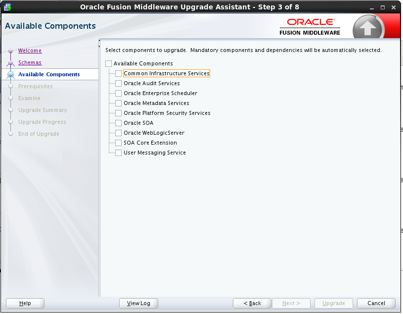

A.1.6 Available Components
If you selected the Individually Selected Schemas option in the previous screen to select individual schemas to be upgraded - instead of upgrading all schemas used by the domain - this screen displays the components with schemas that can be upgraded. If you select a component that requires another schema, the Upgrade Assistant will automatically select those schemas for you.
Figure A-2 List of Components with Schemas Available for Upgrade
Description of Figure A-2 follows
Description of "Figure A-2 List of Components with Schemas Available for Upgrade"

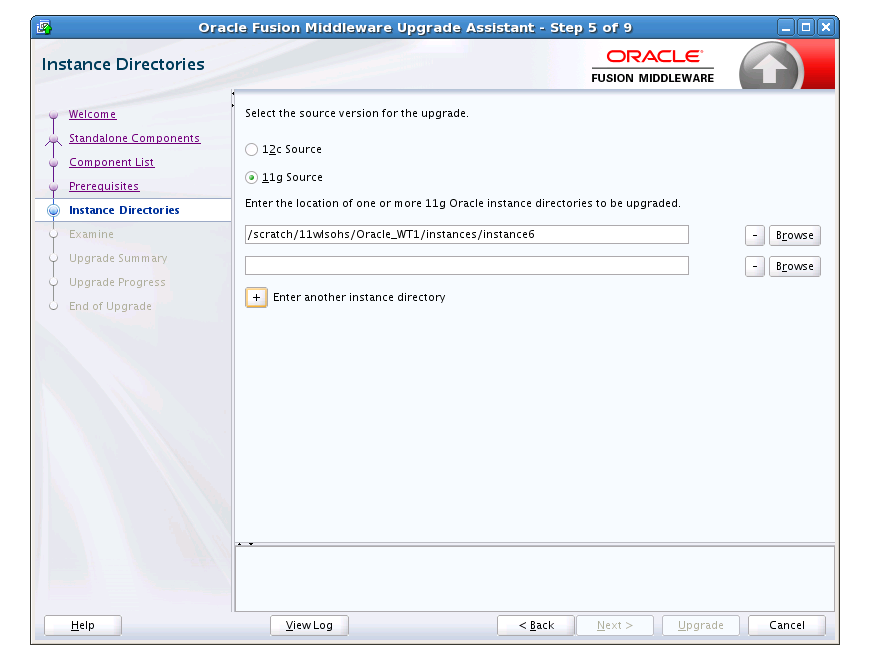

A.1.12 Instance Directories
When upgrading system components, such as OHS, you must provide the directory locations of the 11g instances that will be used as a starting point for creating new 12c component instances.
Use the Add button to include more than one instance, if needed.
NOTE: You cannot use the Upgrade Assistant to upgrade Oracle 10g instances to Oracle 12c. You must first upgrade Oracle 10g instances to 11g. For more information on migrating 10g to 11g, see the 11g upgrade documentation for your components.
Figure A-9 Instance Directories
Description of Figure A-9 follows
Description of "Figure A-9 Instance Directories"

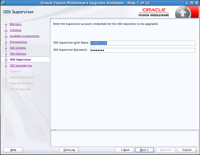

A.1.15 ODI Supervisor
When you created the Master and Work repositories for ODI, the Repository Creation Utility prompted you to supply a password for the default SUPERVISOR account. On the ODI Supervisor screen, enter the following:
Element Description
ODI Supervisor User Name
Supervisor account name for the ODI repository to be upgraded. The Supervisor user should be SUPERVISOR (all CAPS).
ODI Supervisor Password
Password that you created for the ODI Supervisor account.
Figure A-11 Oracle Data Integrator (ODI) Supervisor

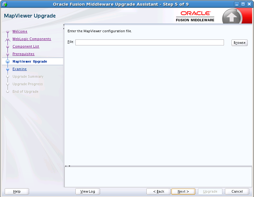

A.1.21 MapViewer
On the MapViewer Upgrade page, for File specify the mapViewerConfig.xml file of the old MapViewer deployment, .and click Next.
This file is needed for migrating its system configuration settings. From this file's location, the old MapViewer's deployment directories are also derived.
Figure A-17 MapViewer Configuration File Directory
Description of Figure A-17 follows
Description of "Figure A-17 MapViewer Configuration File Directory"

A.2.3 Readiness Check Type: Domain Based
The Domain Based option is used to check all of the upgrade-eligible schemas and/or component configurations used by the domain. The Upgrade Assistant detects all of the schemas for you. You can check schemas and component configurations at the same time. Or, if you prefer, you can select one or the other. In either case, you must specify the Domain Directory that is to be reviewed.
You have several options when checking the WebLogic Server domain.
You can select one - or more - of the following options each time you run the Domain Based Readiness Check:
  • Include checks for all schemas
    Select this option to enable the Upgrade Assistant to discover and review all components that have a schema available to upgrade.
  • Include checks for all configurations
    Select this option to review component configurations for a managed WebLogic Server domain.
  • Perform online and offline readiness checks.
    Select this option to perform additional online readiness checks . This option will require your domain to be online. You must provide the domain's host name, port, user name, and password that you plan to check.
    If you do not select this option your domain can be offline. You must provide the domain location that you plan to check.
Figure A-29 WebLogic Server Readiness Check Options

A.2.4 Available Components
This screen appears if you select Individually Selected Schemas in the Schemas screen.
Figure A-30 Available Components
img/GUID-2490F652-0957-4372-AE95-5980F3E02C48-default.png
If you chose Individually Selected Schemas this screen lists the available components for which the schemas will be selected. If you select something here, readiness check will be performed on that component's schema. You must select one or more components from the list to perform readiness check on them.
