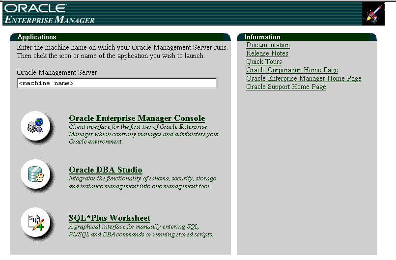

After performing the above steps, you are ready to run the browser-based Oracle Enterprise Manager.
Note: In order to run Enterprise Manager from a web browser, you must remove any proxies that are configured for use by your web browser. You can do this by either:
If you should experience problems with the proxies, refer to "Troubleshooting the Web Browser" on page C-16. |
http://<webserver hostname>:<port number>/
oem_webstage/EMWebSite.html
For example:
http://jfox-sun:3339/oem_webstage/EMWebSite.html
If you are entering the URL for the first time, you must install Oracle JInitiator Release 1.1.7 or higher plug-in.
Once the java plug-in is installed, the Oracle Enterprise Manager Login dialog will appear.
