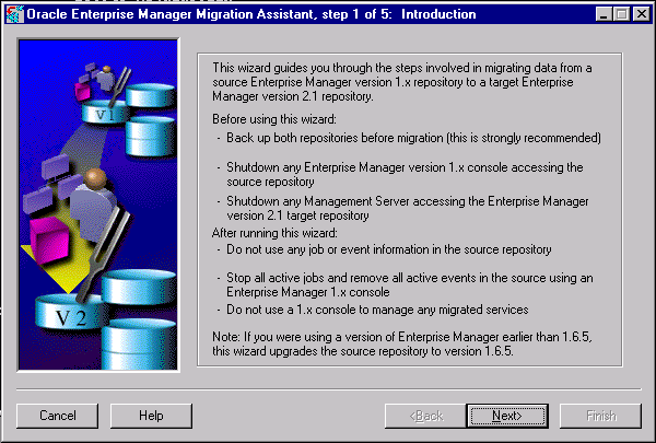

Step 1 "Introduction"
After launching the Migration Assistant, the "Introduction" page appears, providing important information about the purpose of the Migration Assistant and any preconditions that are required for the migration to be successful.

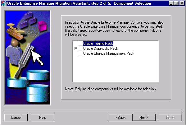

Step 2 "Component Selection"
The Component Selection page only appears if you have one or more system management packs installed.
Choose the repository components that you want to migrate.
Only installed components are available for selection. If a valid target repository does not exist for the component, one will be created.
After you have made your selection, press the Next button to continue.

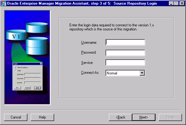

Step 3 "Source Repository Login"
Login to the database where the Release 1.x repository is located.
Username and Password: You must provide a valid username for the database where the Release 1.x repository is located.
Service: Use the standard SQL*Net V2 or Net8 syntax. The service name is the name of the database as it appears in the tnsnames.ora file.
Connect As: Connect as "Normal."
Press Next to continue.
If the information supplied is valid and a valid Release 1.x repository is present, proceed to Step 4 "Target Repository Login" on page 7-16.

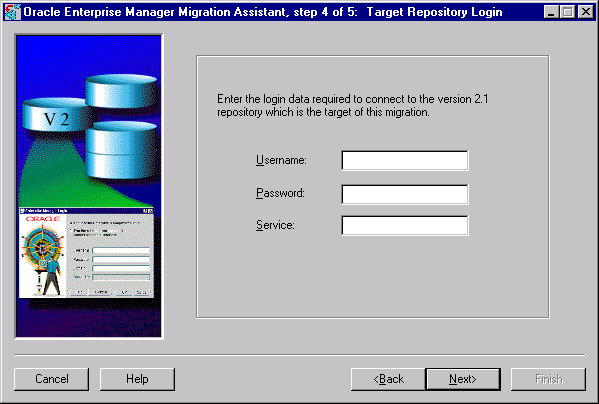

Provide the username, the password, and the service name for the new Release 2.1 repository.
Username and Password: The Oracle Enterprise Manager username must be the same as the username under which the Release 2.1 repository is created. In other words, these are the repository schema owner's credentials. The Oracle Enterprise Manager Release 2.1 repository is an Oracle database schema. The user name and password is not the Oracle Enterprise Manager user logon.
If you have provided a valid repository name, password, and service for a valid Release 2.1 repository, proceed to Step 5 "Administrator Data" on page 7-17. The Oracle Enterprise Manager Migration Assistant also informs you through a dialog if the information to be migrated already exists in the Release 2.1 repository and if the format of the information is different from the format of the Release 1.x information and how this information has been converted.

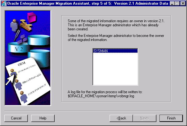

Specify the Release 2.1 administrator where the information will be migrated.
If you have not created additional Release 2.1 administrator accounts, all object migrated will be migrated to the SYSMAN administrator account.
Click Finish to initiate the migration process or click Back to return to previous pages to change the information.
