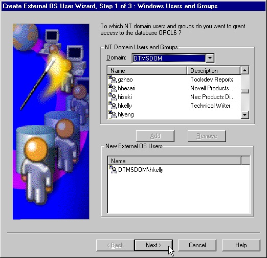

Use one of the following tools to authenticate external user names:
Starting with Oracle release 8.1.5, external users created in the database were automatically prefixed with the domain name. For example, for a Windows NT user DOMAIN1\NTUSER1, the Oracle user created in the database is DOMAIN1\NTUSER1. If you want to create the Oracle user in the database without prefixing with the domain name, you first need to set the registry value OSAUTH_PREFIX_DOMAIN in HKEY_LOCAL_MACHINE\SOFTWARE\ORACLE\HOMEID to FALSE.
Note that it is less secure if you do not prefix the domain name. Therefore, if you migrate a database with external users to Oracle8i for Windows NT, you have two options:

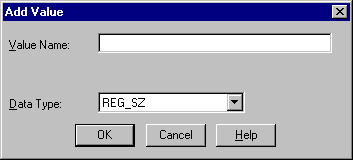

To set the OSAUTH_X509_NAME registry parameter:
  1. Go to the computer on which the Oracle8i database is installed.
  2. Choose Start > Run.
  3. Enter REGEDT32 in the Open field, and click OK.
    The Registry Editor window appears.
  4. Go to HKEY_LOCAL_MACHINE\SOFTWARE\ORACLE\HOMEID.
    where ID is the Oracle home that you want to edit.

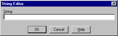

  5. Double-click OSAUTH_X509_NAME.
    A String Editor dialog box appears.
  6. Set the value to TRUE in the String field.
  7. Click OK.
  8. Choose Exit from the Registry menu.
    The registry editor exits.

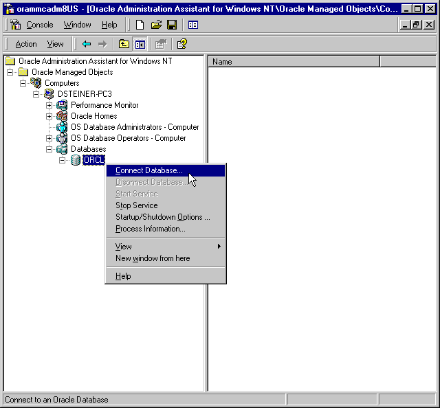

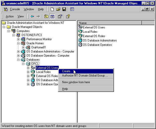

Adding a Computer and Saving Your Configuration
When you use Oracle Administration Assistant for Windows NT for the first time, it adds the local computer in the navigation tree. You can then add other computers.
To add a computer to the Microsoft Management Console tree:
  1. Choose Start > Programs > Oracle - HOME_NAME > Database Administration > Oracle Administration Assistant for Windows NT.
    The Microsoft Management Console starts.
  2. Double-click Oracle Managed Objects.
    The Computer icon appears.
  3. Right-click Computers.
  4. Choose New > Computer.
    The Add Computer dialog box appears.
  5. Specify the domain and hostname of the computer on which your Oracle database is installed.
  6. Click OK.
  7. Double-click Computers to display the computer you added.
  8. Double-click the computer you added. Several nodes for authenticating database administrators and operators appear:

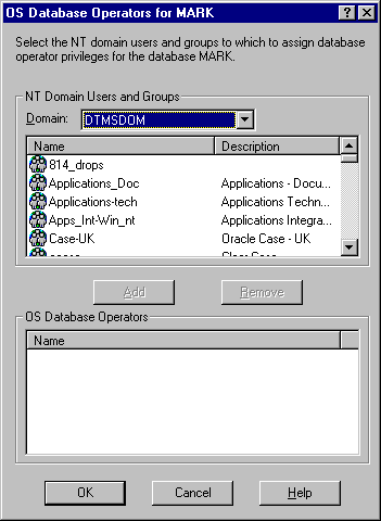

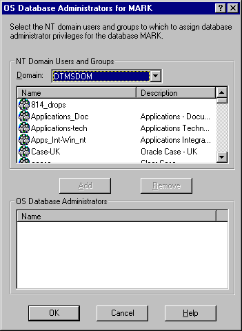

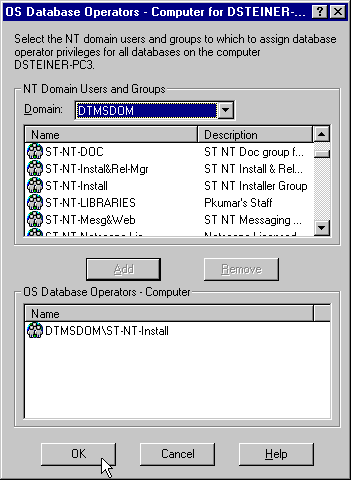

    OS Database Administrators - Computer
    Create an operating system-authenticated database administrator (with SYSDBA privileges) for all database instances on the computer.
    OS Database Operators - Computer
    Create an operating system-authenticated database operator (with SYSOPER privileges) for all database instances on the computer.
  9. Save your configuration in a console file by clicking Save in the Console main menu.
    You can now authenticate database administrators and operators for all instances on the computer.
  10. See "Granting Administrator and Operator Privileges for All Databases on a Computer".

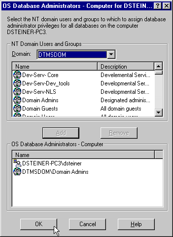

You can grant database administrator (SYSDBA) and database operator (SYSOPER) privileges to DBAs for all databases on a computer.
To grant privileges for all databases on a computer:

Granting Administrator Privileges for All Databases on a Computer
To grant administrator (SYSDBA) privileges for all databases on a computer:
  1. Choose Add/Remove.
    The OS Database Administrators - Computer for hostname dialog box appears:
  2. Select the domain of the user to which to grant SYSDBA privileges from the Domain drop-down list box.
  3. Select the user.
  4. Click Add.
    The user now appears in the OS Database Administrators - Computer window.
  5. Click OK.
Granting Operator Privileges For All Databases on a Computer
To grant operator (SYSOPER) privileges for all databases on a computer:
    The OS Database Operators - Computer for hostname dialog box appears:
  2. Select the domain of the user to which to grant SYSOPER privileges from the Domain drop-down list box.
  3. Select the user.
  4. Click Add.
    The user now appears in the OS Database Operators - Computer window.
  5. Click OK.

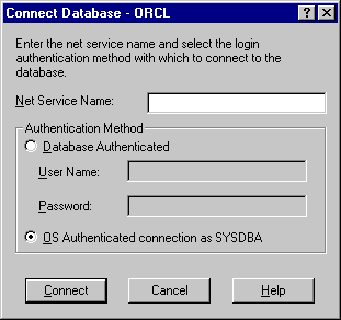

Connecting to a Database
Once you connect to a database, you can perform additional authentication tasks:
To connect to a database:
  1. Right-click the database instance to access (for example, ORCL) in the Microsoft Management Console scope pane:
  2. Choose Connect Database.
    If you connect to the Oracle database, the following Windows NT nodes appear beneath the instance. If these nodes do not appear, double-click the instance.

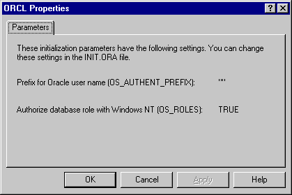

Viewing Database Authentication Parameter Settings
To view database authentication parameter settings:
  1. Right click the database.
  2. Choose Properties.
  3. View the following database properties:
    Parameter  Description
    OS_AUTHENT_PREFIX
    OS_AUTHENT_PREFIX is an INIT.ORA file parameter that authenticates external users attempting to connect to the Oracle database with the user's Windows NT user name and password. The value of this parameter is attached to the beginning of every user's Windows user name. By default, the parameter is set to none ("") during Oracle8i database creation. Create Oracle users in the database without the prefix OPS$, which was needed for Oracle7 and Oracle8 8.0.x.
    Therefore, a Windows domain user name of FRANK is authenticated as user name FRANK. You can set this parameter to an appropriate value. For example, if you set this parameter to XYZ, the Windows NT domain user FRANK is authenticated as user XYZFRANK.
    OS_ROLES
    OS_ROLES is an INIT.ORA file parameter that, if set to TRUE, enables the Windows NT operating system to manage the authorization of external roles for database users. By default, OS_ROLES is set to FALSE. You must set OS_ROLES to TRUE and restart your Oracle database before you can create external roles. If OS_ROLES is set to FALSE, the Oracle database manages the granting and revoking of roles for database users. See section "Understanding the OS_ROLES Parameter" for more information.
OS_ROLES is a parameter in the INIT.ORA file that, if set to TRUE, enables the Windows NT operating system to manage the authorization of external roles for database users. You must set OS_ROLES to TRUE and restart your Oracle database before you can create external roles.
If OS_ROLES is set to TRUE and you assign an external role to an NT global group, it is granted only at the global group level, and not at the level of the individual user in this global group. This means that you cannot revoke or edit the external role assigned to an individual user in this global group through the Roles tab of the Domain\User Name Properties dialog box at a later time. Instead, you must use the Assign External OS Roles to an NT Global Group field in the dialog box to revoke the external role from this global group (and therefore all its individual users).
External roles assigned to an individual domain user or local roles (with OS_ROLES set to FALSE) assigned to an individual domain user or NT global group are not affected by this issue, and can be edited or revoked.
If OS_ROLES is set to TRUE, you can not grant local roles in the database to any database user. You must grant the roles through Windows NT. See "Creating a Local Database Role" and "Creating an External Role" for more information.

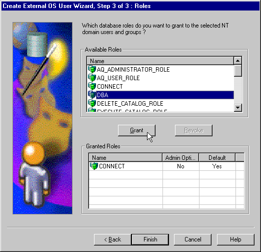

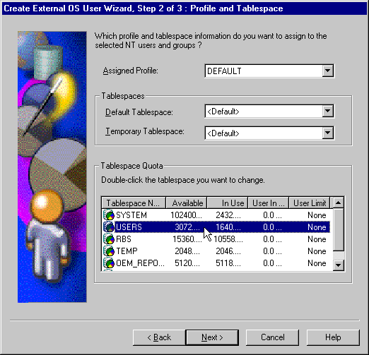

Creating a Nonprivileged Database User (External User)
You can create a nonprivileged database user (external user).
To create a nonprivileged database user:
  1. Follow the steps in "Connecting to a Database" to connect to a database.
  2. Right click External OS Users.
  3. Choose Create.
    The Create External OS User Wizard starts:
  4. Select the domain in which your Windows NT domain users and global groups are located.
  5. Select the Windows NT domain users and global groups to which to grant access to the database.
  6. Click Add.
    The user now appears in the New External OS Users window.
    If you select an NT global group for authentication when using Oracle Administration Assistant for Windows NT, all users currently in the group are added to the Oracle database. If at a later time, you use a Windows NT tool to add or remove users in this NT global group, these updates are not reflected in the Oracle database. The newly added or removed users must be explicitly added or removed in the Oracle database with Oracle Administration Assistant for Windows NT.
  7. Click Next.
  8. Select a profile for the new external users. A profile is a named set of resource limits. If resource limits are enabled, Oracle limits database usage and instance resources to whatever is defined in the user's profile. You can assign a profile to each user, and a default profile to all users who do not have specific profiles.
  9. Double-click the tablespace to assign a tablespace quota in the Tablespace Quota window. This assigns profile and tablespace information to the users, and grants database roles.
  10. Click Next.
  11. Select the database roles to grant to the new external users.
  12. Click the Grant button.
  13. Click Finish.
  14. Right click the external user for which you want to view information and select Properties.
    The assigned properties appear.

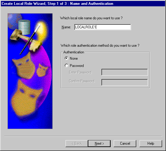

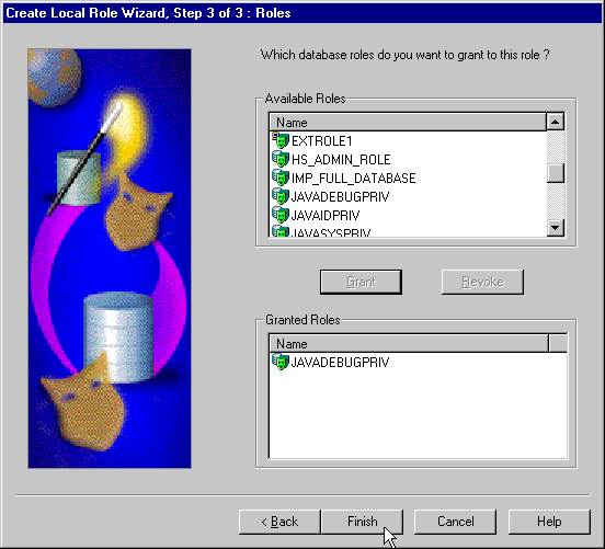

You can create a local database role.
To create a local database role:
  2. Right click Local Roles for the database for which you want to create a local role.
  3. Click Create.
    The Create Local Role wizard appears:
  4. Enter a local role name to use. A local role is a role that is managed by the Oracle database.
  5. Select None if you want a user to use this local role without being required to enter a password.
  6. Select Password if you want the use of this role to be protected by a password. These roles can only be used by supplying an associated password with the SET ROLE command. See the Oracle8i Administrator's Guide for additional information.
  7. Enter the password to use with this role.
  8. Confirm the password by entering it a second time.
  9. Click Next.
  10. Select appropriate system privileges to assign to the local role.
  11. Click Grant to grant the selected system privileges to the local role.
    The Granted System Privileges field displays the list of system privileges granted to the local role. To revoke a system privilege, make an appropriate selection, then click Revoke.
  12. If you want to grant the Admin Option to this role, click the value in the Admin Option column to display a drop-down list box. This enables you to select Yes.
  13. Click Next.
  14. Select appropriate roles to assign to the local role. Both local roles and external roles appear in this list.
  15. Click Grant to grant the selected roles to the role.
    The Granted Roles field displays the list of roles granted to the role. Both local roles and external roles can appear in this list. To revoke roles, make appropriate selections, then click Revoke.
  16. Click Finish.

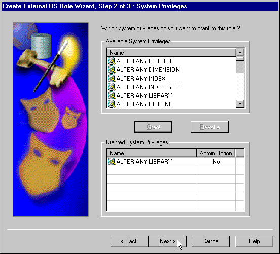

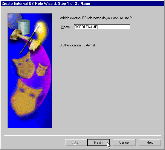

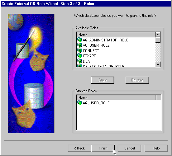

You can create external roles.
To create an external role:
  2. Right click External OS Roles for the database for which to create an external role.
  3. Click Create.
    This wizard is only available if you set the INIT.ORA parameter OS_ROLES to TRUE and restart the Oracle database.
    "Authentication: External" appears on this page to indicate that only external roles can be created.
  4. Enter an external role name to use. An external role is a role that is managed by the Windows operating system.
  5. Click Next.
  6. Select appropriate system privileges to assign to the external role.
  7. Click Grant to grant the selected system privileges to the external role.
  8. The Granted System Privileges field displays the list of system privileges granted to the external role. To revoke a system privilege, make an appropriate selection, then click Revoke.
  9. If you want to grant the Admin Option to this role, click the value in the Admin Option column to display a drop-down list box. This enables you to select Yes.
  10. Click Next.
  11. Select appropriate roles to assign to the external role.
  12. Click Grant to grant the selected roles to the external role. Both local roles and external roles appear in this list.
    The Granted Roles field displays the list of roles granted to the external role.
  13. Click Finish.

Granting Administrator Privileges for a Single Database
To grant administrator (SYSDBA) privileges for a single database:
    The OS Database Administrators for instance dialog box (MARK in this example) appears:
  2. Select the domain of the user to which to grant SYSDBA privileges from the NT Domain Users and Groups drop-down list box.
  3. Select the user. The user now appears in the OS Database Administrators window.
  4. Click OK.
Granting Operator Privileges for A Single Database
To grant operator (SYSOPER) privileges for a single database:
    The OS Database Operators for instance dialog box (MARK in this example) appears:
  2. Select the domain of the user to which to grant SYSOPER privileges from the NT Domain Users and Groups drop-down list box.
  3. Select the user.
  4. Click Add.
    The user now appears in the OS Database Operators window.
  5. Click OK.

    3. Choose the Add Value option in the Edit menu.
      The Add Value dialog box appears:
    4. Enter OSAUTH_PREFIX_DOMAIN in the Value Name field.
    5. Choose REG_EXPAND_SZ from the Data Type drop-down list box.
    6. Click OK.
      The String Editor dialog box appears:
    7. Enter TRUE in the String field to enable authentication at the domain level.
      TRUE enables the server to differentiate between multiple FRANK user names, whether they are local user FRANK, domain user FRANK on SALES, or domain user FRANK on another domain in your network. Entering FALSE causes the domain to be ignored and local user FRANK to become the default value of the operating system user returned to the server.
    8. Click OK.
      The Registry Editor adds the parameter.

  2. Ensure that you have the following line in your ORACLE_BASE\ ORACLE_HOME\NETWORK\ADMIN\SQLNET.ORA file:
    SQLNET.AUTHENTICATION_SERVICES = (NTS)
  3. Use Net8 Assistant to configure a network connection from your client computer to the Windows NT server on which your Oracle8i database is installed. See the Net8 Administrator's Guide for instructions.
  4. Start SQL*Plus:
    C:\> SQLPLUS
  5. Connect to your Windows NT server:
    SQL> CONNECT /@NET_SERVICE_NAME
    where NET_SERVICE_NAME is the Net8 network service name for the Oracle8i database that you created in Step 3.
    The Oracle8i database searches the data dictionary for an automatic login user name corresponding to the Windows NT local or domain user name, verifies it, and allows you to connect as XYZFRANK or XYZSALES\FRANK.
  6. Verify that you have connected to the Oracle8i database as local or domain user FRANK by viewing the roles assigned in Step 9 of "Step 1: Perform Authentication Tasks on the Oracle8i Database Server".
    SQL> SELECT * FROM USER_ROLE_PRIVS;
    which outputs for local user FRANK:
    USERNAME                       GRANTED_ROLE                   ADM DEF OS_
    XYZFRANK                       CONNECT                        NO  YES NO
    XYZFRANK                       RESOURCE                       NO  YES NO
    2 rows selected.
    or, for domain user FRANK:
    XYZSALES\FRANK                 CONNECT                        NO  YES NO
    XYZSALES\FRANK                 RESOURCE                       NO  YES NO
    2 rows selected.

Granting Administrator and Operator Privileges for Databases
This section describes how to enable Windows NT to grant the database administrator (SYSDBA) and database operator (SYSOPER) privileges to DBAs. This enables DBAs to issue the following commands from a client computer and connect to the Oracle8i database without entering a password:
To enable this feature, the Windows NT local or domain user name of the client must belong to one of the following four Windows NT local groups on the server:
Local Group  This Local Group Includes All...
ORA_OPER
SYSOPER database privileges; applicable for all databases on a computer.
ORA_DBA 1
SYSDBA database privileges; applicable for all databases on a computer.
ORA_SID_DBA
SYSDBA database privileges; applicable only for a single database on a computer (identified by the SID).
ORA_SID_OPER
SYSOPER database privileges; applicable only for a single database on a computer (identified by the SID).
1 ORA_DBA is automatically created during installation. See section "Automatically Enabling Operating System Authentication During Installation" for information.
The SYSOPER and SYSDBA privileges are mapped to the following Windows NT local groups:
This Privilege...  Maps to the Local Group...
SYSOPER
ORA_SID_OPER, ORA_OPER
SYSDBA
ORA_SID_DBA, ORA_DBA, ORA_SID_OPER, ORA_OPER
Follow the steps below to connect as SYSOPER or SYSDBA without a password:
To perform authentication tasks on the Oracle8i database server:

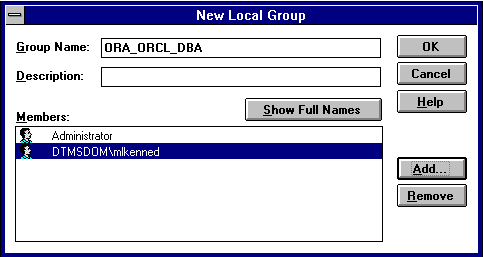

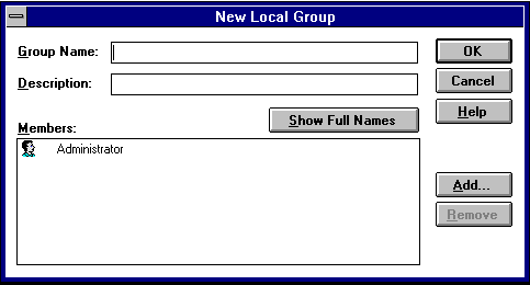

  1. Open User Manager on the Windows NT server where your Oracle8i database is installed.
  2. Choose New Local Group from the User Menu.
    The New Local Group dialog box appears.

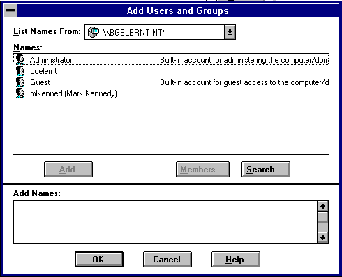

  3. Enter the appropriate Windows NT local group name in the Group Name field. For this example, the SID entered is ORCL.
  4. Click Add.
    The Add Users and Groups dialog box appears:
  5. Select an appropriate Windows NT user from the Names field and click Add.
  6. Click OK.
    Your selection is added to the Members field of the New Local Group dialog box:
  7. Click OK.
  8. Exit User Manager.
  9. Ensure that you have the following line in your ORACLE_BASE \ORACLE_HOME\NETWORK\ADMIN\SQLNET.ORA file:
  10. In the registry in HKEY_LOCAL_MACHINE\SOFTWARE\ORACLE\HOMEID set the parameter OSAUTH_PREFIX_DOMAIN to TRUE.
Step 2: Perform Authentication Tasks on the Client Computer
To perform authentication tasks on the client computer:
  1. Create a Windows NT local or domain user name with the same user name and password that exist on the Windows NT server (if the appropriate user name does not currently exist).
  2. Ensure that you have the following line in your ORACLE_BASE\ORACLE_HOME\NETWORK\ADMIN\SQLNET.ORA file:
  3. Use Net8 Assistant to configure a network connection from your client computer to the Windows NT server on which your Oracle8i database is installed. See Net8 Administrator's Guide for instructions.
  4. Start SQL*Plus:
    C:\> SQLPLUS
  5. Connect to the Oracle8i database:
    SQL> SET INSTANCE NET_SERVICE_NAME
  6. Connect as SYSOPER or SYSDBA based on the local group you specified in step 3 of "Step 1: Perform Authentication Tasks on the Oracle8i Database Server":
    If The Local Group Is...  Then Enter...
    ORA_DBA or ORA_SID_DBA
    SQL> CONNECT / AS SYSOPER
    or
    SQL> CONNECT / AS SYSDBA
    ORA_OPER or ORA_SID_OPER
    You are connected to the Windows NT server. If you connect with SYSDBA, you are given DBA privileges.
This section describes how to grant Oracle8i database roles to users directly through Windows NT (known as external roles). When you use Windows NT to authenticate users, Windows NT local groups can grant these users external roles. Through User Manager, you can create, grant, or revoke external roles to users.
All privileges for these roles are active when the user connects. When using external roles, all roles are granted and managed through the operating system. You cannot use both external roles and Oracle roles at the same time. For example:
If You...  Then...
  1. Enable external roles.
You only receive the roles granted to DTMSDOM\FRANK, and not the roles granted to SCOTT.
  1. Log onto a Windows NT domain with your domain user name; for example, SALES\FRANK, where SALES is the domain name and FRANK is the domain user name.
  1. Connect to the Oracle8i database as Oracle database user SCOTT.
Follow the steps below to grant external roles with Windows NT:
  1. Add the OS_ROLES initialization parameter to the INIT.ORA file.
  2. Set OS_ROLES to TRUE.
    The default setting for this parameter is FALSE.
  3. Ensure that you have the following line in your ORACLE_BASE \ORACLE_HOME\NETWORK\ADMIN\SQLNET.ORA file:
  4. Start SQL*Plus:
    C:\> SQLPLUS
    SQL> CONNECT INTERNAL
  6. Create a new database role:
    SQL> CREATE ROLE DBSALES3 IDENTIFIED EXTERNALLY;
    where DBSALES3 is the name of the role for these steps. Substitute a role name appropriate to your database environment.
  7. Grant Oracle roles to DBSALES3 that are appropriate to your database environment:
    SQL> GRANT DBA TO DBSALES3 WITH ADMIN OPTION;
    SQL> GRANT RESOURCE TO DBSALES3 WITH ADMIN OPTION;
    SQL> GRANT CONNECT TO DBSALES3 WITH ADMIN OPTION;
  8. Connect to the database with the INTERNAL DBA name:
  9. Shut down the database:
    SQL> SHUTDOWN
  10. Restart the database:
    SQL> STARTUP

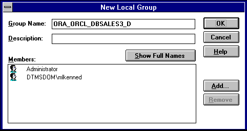

  11. Open the Windows NT User Manager.
  12. Choose New Local Group from the User menu.
    The New Local Group dialog box appears:
  13. Enter the Windows NT local group name corresponding to the database role in the Group Name field with the following syntax:
    ORA_SID_ROLENAME [_D] [_A]
    where:
    SID
    Indicates the database instance.
    ROLENAME
    Identifies the database role granted to users of a database session.
    D
    Optional character indicating that this database role is to be the default role of the database user. If specified, this character must be preceded by an underscore.
    A
    Optional character indicating that this database role includes the ADMIN OPTION. This enables the user to grant the role to other roles only. If specified, this character must be preceded by an underscore.
    For this example, ORA_ORCL_DBSALES3_D is entered.
  14. Click Add.
  15. Select the appropriate Windows NT local or domain user name and click Add.
  16. Click OK.
