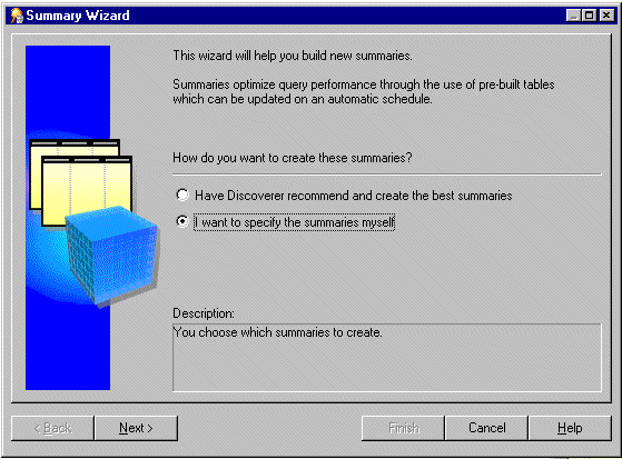

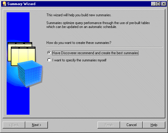

In this exercise you will use the Summary Wizard to create summary folders using Automated Summary Management (ASM).
ASM is a Discoverer facility that creates and manages summary folders for you.
You can run ASM in the following ways:
When using the Load Wizard: Step 4 dialog you can select the Summaries based on folders that are created check box (for more information, click Help).
To create a summary folder using ASM:

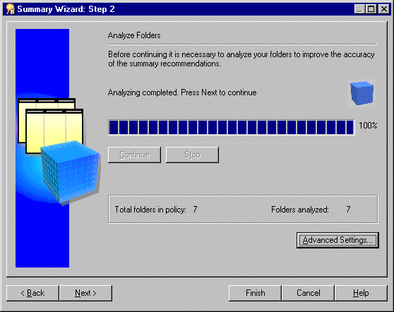

ASM starts by analyzing folders in the current EUL so that it can propose a suitable set of summary folders to create.
Discoverer displays a progress bar that indicates the number of folders being analyzed.
When folder analysis is complete, Discoverer displays the message Analyzing completed. Press Next to continue.

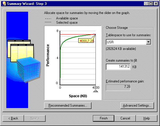

This dialog enables you to set the size of table space that you want ASM to fill with summary folders. Both the graph pointer and the Create summaries to fill field enable you to alter the size of the table space that Discoverer will use.
Note: Do not reduce the values to either the Table space to use for summaries field or the Create summaries to fill field.
Note: The estimated performance gain displayed above is calculated partly from query statistics gathered from end user queries and partly from data about the database tables. The performance gain can be very large in normal use because Discoverer collects statistics from end user queries that have previously been executed. However, Discoverer might not yet have collected any end user query statistics.

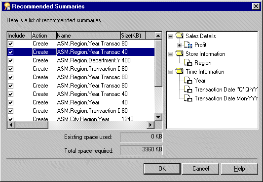

The Recommended Summaries dialog displays the summary folders suggested by ASM.

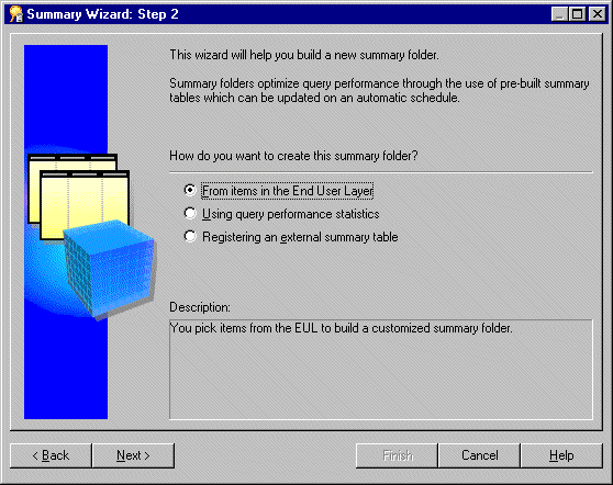

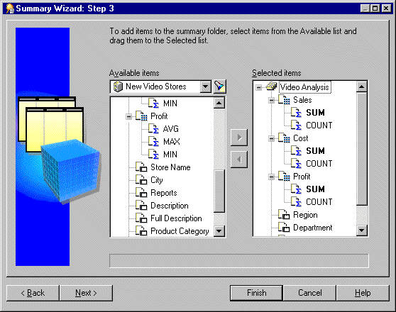

In this exercise you will use the Summary Wizard to create summary folders manually by specifying summary folders that are based on items that exist in the EUL.
To manually create a summary folder:

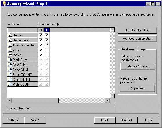

Your next task is to choose the summary combinations that you want Discoverer to build and manage.
Note: Summary combination are individual sets of axis and measure items that together make up a summary folder. If an end user runs a query with the same items as those specified in a summary combination, the query will run against pre-aggregated summary data instead of the detail data in the database. Consequently, the query performance is improved because it uses the pre-aggregated data instead of scanning all the detail rows.
In the Summary Wizard: Step 4 dialog, each numbered column represents a summary combination.

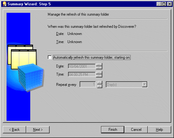

Your next task is to schedule the initial summary folder refresh and periodic refresh intervals then name the summary folder and schedule its build.
Note: The refresh schedule establishes the time frame in which Discoverer automatically updates the data in the summary folder. It is important for you, as the Discoverer manager, to set up a periodic refresh that ensures that the aggregated summary data is current at the periods required by end users.

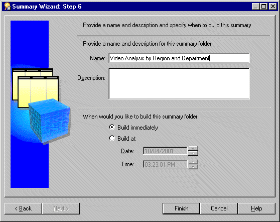

Video Analysis by Region and Department in the Name field.
Discoverer displays a progress bar while creating the summary.
