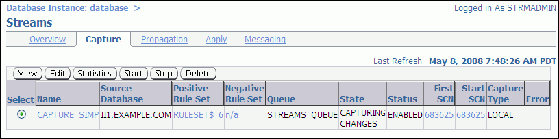

To start or stop a capture process:
In Oracle Enterprise Manager, log in to the database as the Oracle Streams administrator.
Go to the Database Home page.
Click Data Movement to open the Data Movement subpage.
Click Manage in the Streams section.
The Streams page appears, showing the Overview subpage.
Click Capture to open the Capture subpage.
Select the capture process that you want to start or stop.
Click Start to start a disabled or aborted capture process, or click Stop to stop an enabled capture process.
Click Yes on the confirmation page to finish starting or stopping the capture process.
You can also use theSTART_CAPTURE procedure and STOP_CAPTURE procedure in the DBMS_CAPTURE_ADM package to start and stop a capture process.This topic contains instructions for setting capture process parameters in Enterprise Manager. Capture process parameters control the way a capture process operates. You can set a parameter to change a specific way in which a capture process operates. For example, you can change the parallelism capture process parameter to control the number of processes that capture changes. Typically, you adjust capture process parallelism to achieve the best capture process performance.

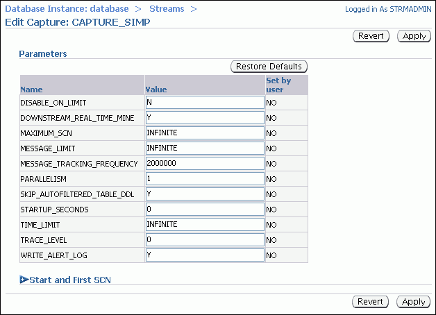

To set a capture process parameter:
Select the capture process that you want to modify.
Click Edit to open the Edit Capture page.
Modify one or more capture process parameters in the Parameters section.
See Oracle Database PL/SQL Packages and Types Reference for information about the parameters. If you change the parallelism parameter, then the capture process automatically stops and restarts when you click Apply.
Click Apply to save your changes.
You can also use theDBMS_CAPTURE_ADM.SET_PARAMETER procedure to set a capture process parameter.This topic contains instructions for enabling or disabling a propagation in Enterprise Manager.

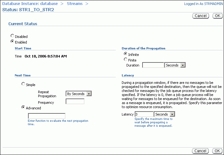

You might need to disable a propagation if the database to which the propagation sends messages goes down or if a network problem prevents the propagation from sending messages. In these situations, you can disable the propagation and enable it when the problem is corrected.
Also, a propagation becomes disabled automatically after it fails to send messages in 16 consecutive attempts. When this happens, the error is displayed on the Propagation subpage of the Streams page in Enterprise Manager. In this case, you should correct the error and enable the propagation.
To enable or disable a propagation:
Click Propagation to open the Propagation subpage.
Click the link in the Status field of the propagation that you want to enable or disable. The link text is either Enabled or Disabled.
The Status page for the propagation appears.
Change the status to either Enabled or Disabled in the Current Status section.
Do not modify the settings under any of the following sections: Next Time, Duration of Propagation, or Latency. Generally, the default values in these sections provide the most efficient propagation. Modifying the propagation schedule is outside the scope of this guide.
Click OK to save your changes.

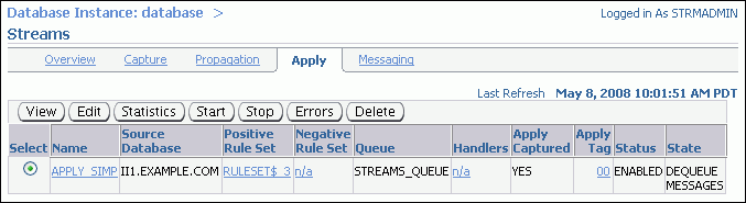

To start or stop an apply process:
Click Apply to open the Apply subpage.
Select the apply process that you want to start or stop.
Click Start to start a disabled or aborted apply process, or click Stop to stop an enabled apply process.
Click Yes on the confirmation page to finish starting or stopping the apply process.
You can also use theSTART_APPLY procedure and STOP_APPLY procedure in the DBMS_APPLY_ADM package to start and stop an apply process.This topic contains instructions for setting apply process parameters in Enterprise Manager. Apply process parameters control the way an apply process operates. You can set a parameter to change a specific way in which an apply process operates. For example, you can change the parallelism apply process parameter to control the number of processes that apply changes. Typically, you adjust apply process parallelism to achieve the best apply process performance.

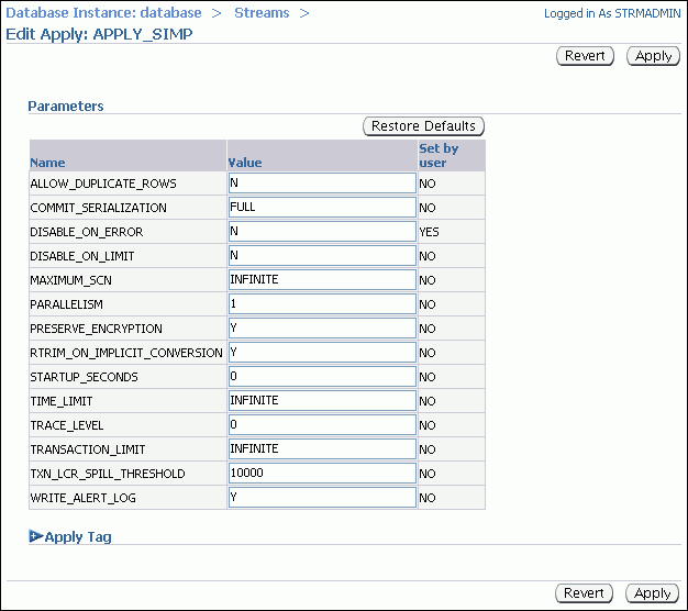

To set an apply process parameter:
Select the apply process that you want to modify.
Click Edit to open the Edit Apply page.
Modify one or more apply process parameters in the Parameters section.
See Oracle Database PL/SQL Packages and Types Reference for information about the parameters. If you change the parallelism parameter, then the apply process automatically stops and restarts when you click Apply.
You can also use theDBMS_APPLY_ADM.SET_PARAMETER procedure to set an apply process parameter.This section describes using Enterprise Manager and SQL*Plus to display general information about replication components and the replication topology. It also contains instructions for monitoring capture processes, propagations, and apply processes.

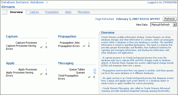

The Overview subpage of the Streams page in Enterprise Manager contains information about the Oracle Streams components in the current database. This information includes:
The number of capture processes, propagations, apply processes, queues, and queue tables in the local database.
The number of capture processes, propagations, and apply processes that currently have errors.
You can click a number to drill down to more information about a component or to manage a component.
To display an overview of the replication components at a database:
The Streams page appears, showing the Overview subpage. Click Help for more information about the Oracle Streams Overview page.

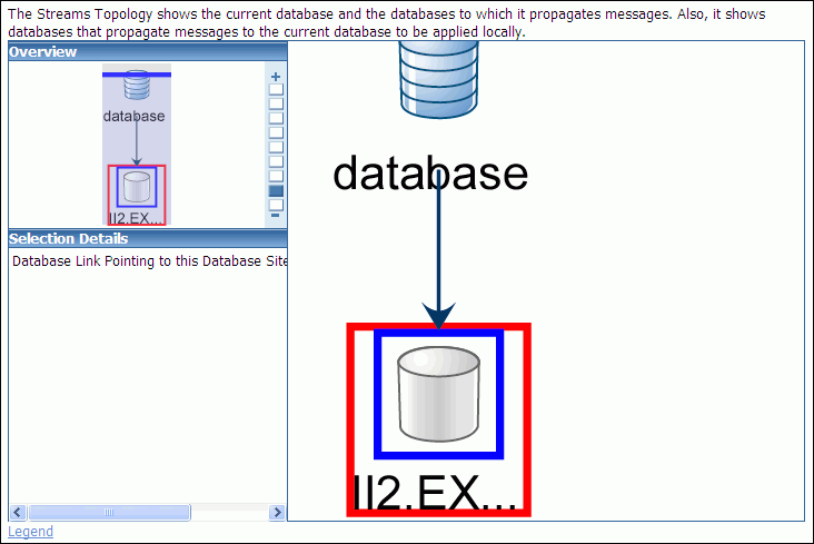

An Oracle Streams topology displays a graphical representation of the local database and other databases that interact with the local database in the Oracle Streams environment. In a replication environment, the topology shows the following information about the databases displayed:
The database links used by propagations from the current database to other databases in the Oracle Streams environment. Each arrow that originates at the current database shows a database link used by a propagation from the current database to another database. Replication environments use database links to send changes made to replicated objects to other databases.
The database links used by propagations from other databases in the Oracle Streams environment to the current database for which an apply process at the current database applies the propagated messages. Each arrow that terminates at the current database shows a database link used by a propagation from another database to the current database whose messages are applied at the current database.
To view the Oracle Streams topology:
Scroll down until you see the Oracle Streams topology.
You can use the Overview window to select a particular portion of the topology to view in detail and to zoom in and zoom out. You can also select a database in the topology and view the Selection Details window for information about the database.
Click Help or the Legend link for more information about the Oracle Streams topology.
The following graphic shows an example of the Oracle Streams topology for an Oracle Streams replication environment:
The Oracle Streams topology in the previous figure includes the following elements:
The current database is named database.
The ii2.example.com database is part of the replication environment that interacts with the current database.
The current database sends changes to the ii2.example.com database, and these changes are applied by an apply process at the ii2.example.com database.

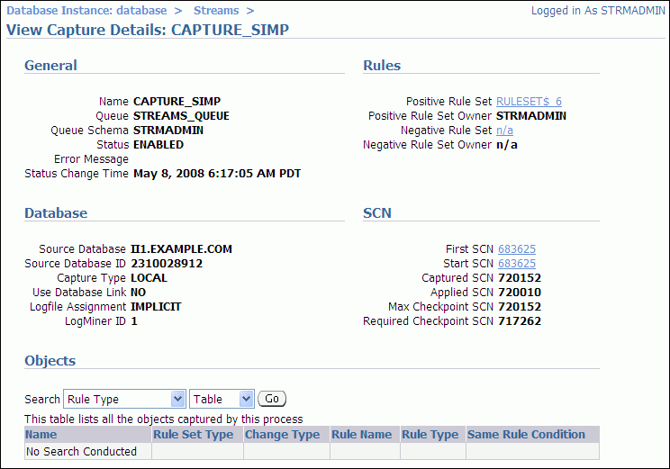

You can use Enterprise Manager to view information about a capture process. This information includes the capture process status and state, the rules used by the capture process, and other information about the capture process.
To view detailed information about a capture process in Enterprise Manager:
The Capture subpage shows general information about each capture process in the database. This information includes capture process rule sets, queue, state, and status. Click Help for more information about the Capture subpage.
Select the capture process that you want to monitor.
Click View to open the View Capture Details page.
The View Capture Details page includes detailed information about the capture process. It also enables you to display the database objects for which the capture process captures changes. Rules control which database changes are captured by a capture process. Use the search tool in the Objects section to display the capture process rules:
To display all of the rules in the positive rule set, choose Positive Rule Type and click Go. Positive rules instruct a capture process to capture changes to database objects.
To display all of the rules in the negative rule set, choose Negative Rule Type and click Go. Negative rules instruct a capture process not to capture changes to database objects.
Click Help for more information about this page.

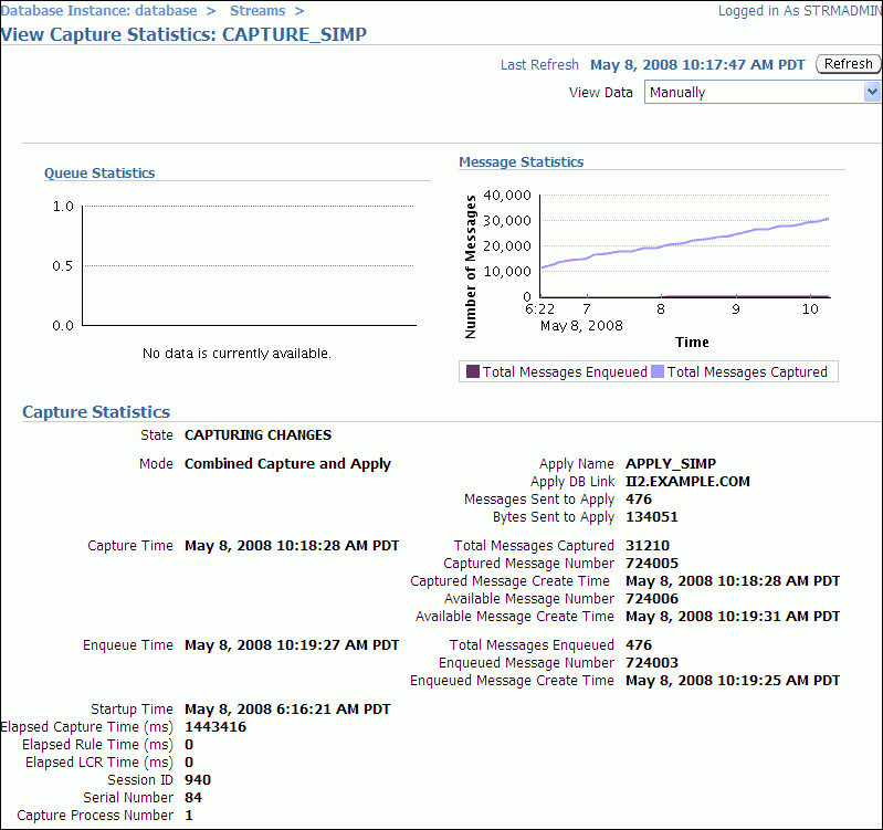

To view statistics for a capture process in Enterprise Manager:
Click Statistics to open the View Capture Statistics page.
The View Capture Statistics page includes the following information:
The Queue Statistics graph shows the number of messages currently in the capture process queue. The No of Enqueued Messages line in the graph shows the total number of messages currently in the buffered queue. The No of Spilled Messages line in the graph shows the total number of messages that have spilled from memory into the persistent queue table.
The Message Statistics graph shows the total number of changes enqueued and captured by the capture process since it last started. Total Messages Enqueued shows the number of changes enqueued by the capture process. Total Messages Captured shows the number of changes that were evaluated in detail against the capture process rules. If a change does not satisfy the capture process rules, then the change is not enqueued.
The Capture Statistics section includes the current state of the capture process, as well as statistics related to time and changes (messages) captured. See the documentation for the V$STREAMS_CAPTURE dynamic performance view in Oracle Database Reference for more information about these statistics.

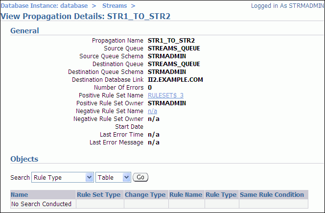

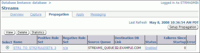

You can use Enterprise Manager to view information about a propagation. This information includes the propagation status, whether the propagation has failed, the rules used by the propagation, and other information about the propagation.
To view information about a propagation in Enterprise Manager:
Select the propagation that you want to monitor.
Click View to open the View Propagation Details page for the propagation.
The View Propagation Details page includes detailed information about the propagation. It also enables you to display the database objects for which the propagation sends changes. Rules control which database changes are sent by a propagation. Use the search tool in the Objects section to display the propagation rules:
To display all of the rules in the positive rule set, choose Positive Rule Type and click Go. Positive rules instruct a propagation to send changes to database objects to the destination queue.
To display all of the rules in the negative rule set, choose Negative Rule Type and click Go. Negative rules instruct a propagation not to send changes to database objects to the destination queue.
You can also query theALL_PROPAGATION data dictionary view for information about a propagation.You can use Enterprise Manager to view statistics for a propagation. The statistics include the number of messages in the propagation source queue, the number of messages sent by the propagation, and other statistics relating to the propagation.

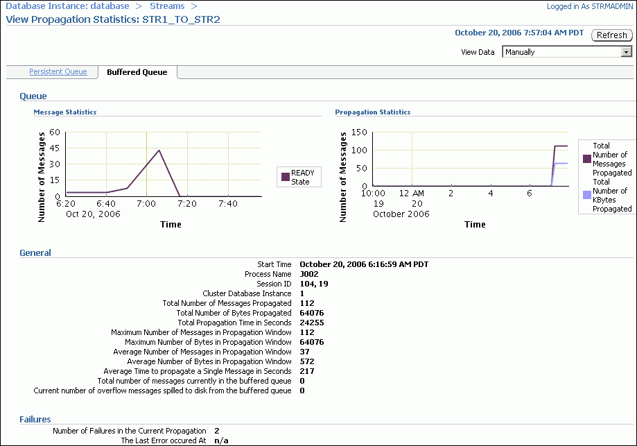

Propagation statistics are not calculated when combined capture and apply is used.To view statistics for a propagation in Enterprise Manager:
Click Statistics to open the View Propagation Statistics page for the propagation.
The View Propagation Statistics page includes the following subpages:
The Persistent Queue subpage shows propagation statistics for messages that were enqueued into the persistent queue portion of the queue used by the propagation. Use this subpage to view propagation statistics if the propagation sends changes captured by a synchronous capture.
The Buffered Queue subpage shows propagation statistics for messages that were enqueued into the buffered queue portion of the queue used by the propagation. Use this subpage to view propagation statistics if the propagation sends changes captured by a capture process.
Both subpages contain graphs that show the number of messages in the queue and the number of messages sent by the propagation over several hours. Both subpages also contain other propagation statistics, such as the total number of messages and bytes propagated since the propagation was last started. Click Help for more information about the statistics on the current subpage.
You can also query the following dynamic performance views for buffered queue statistics and propagation statistics:See Also:
Oracle Streams Concepts and Administration for information about combined capture and apply
You can use Enterprise Manager to view detailed information about apply processes. You can also view statistics for apply processes.
The following topics describe monitoring apply processes:
You can use Enterprise Manager to view information about an apply process. This information includes the apply process status and state, the rules used by the apply process, and other information about the apply process.

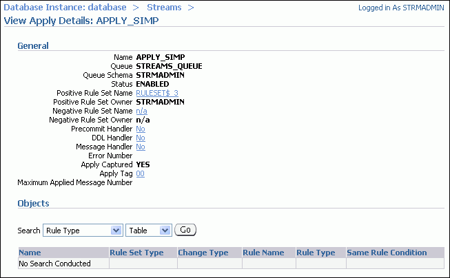

To view information about an apply process in Enterprise Manager:
Select the apply process that you want to monitor.
Click View to open the View Apply Details page.
The View Apply Details page includes detailed information about the apply process. It also enables you to display the database objects for which the apply process applies changes. Rules control which database changes are dequeued and applied by an apply process. Use the search tool in the Objects section to display the apply process rules:
To display all of the rules in the positive rule set, choose Positive Rule Type and click Go. Positive rules instruct an apply process to dequeue and apply changes to database objects.
To display all of the rules in the negative rule set, choose Negative Rule Type and click Go. Negative rules instruct an apply process not to dequeue changes to database objects.
You can also query theALL_APPLY data dictionary view for information about an apply process.You can use Enterprise Manager to view statistics for an apply process. The statistics include the number of messages in the apply process queue, the number of messages applied by the apply process, and other statistics relating to the apply process.

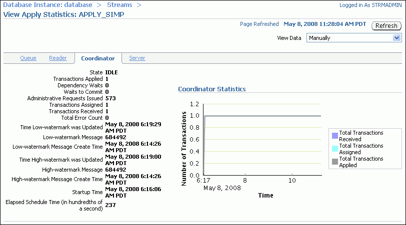

To view statistics for an apply process in Enterprise Manager:
Click Statistics to open the View Apply Statistics page.
The View Apply Statistics page includes the following subpages:
The Queue subpage shows the number of messages over the past several hours in both the persistent queue portion and the buffered queue portion of the apply process queue. If the apply process applies changes captured by a synchronous capture, then analyze the persistent queue statistics. If the apply process applies changes captured by a capture process, then analyze the buffered queue statistics.
The Reader subpage shows statistics for the reader server. The reader server dequeues messages from the apply process queue and assembles them into separate transactions.
The Coordinator subpage shows statistics for the coordinator process. The coordinator process gets transactions from the reader server and passes them to apply servers.
The Server subpage shows statistics for the apply servers. The apply servers apply changes to database objects or pass the changes to apply handlers. To view details about a specific apply server, select it and click View Details.
You can also query the following dynamic performance views for buffered queue statistics and apply process statistics:In a replication environment, update conflict handlers automatically resolve conflicts that occur when the same row is updated at two different databases at nearly the same time. You can use the ALL_APPLY_CONFLICT_COLUMNS data dictionary view to list the update conflict handlers.

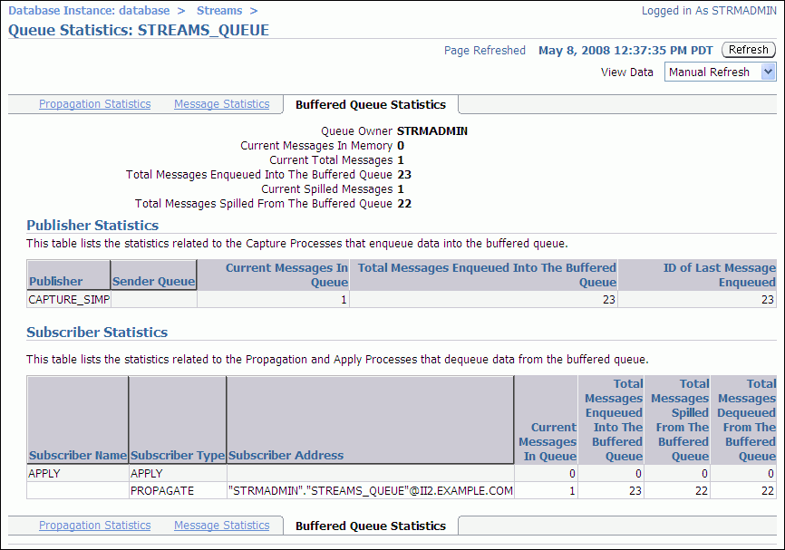

You can use Enterprise Manager to view statistics for a buffered queue that is used by a capture process, propagation, or apply process in your replication environment. In an Oracle Streams replication environment that uses capture processes to capture changes, each capture process enqueues changes into the buffered queue portion of its queue. The changes remain in buffered queues as they are propagated from one queue to another, and apply processes dequeue the changes from a buffered queue.
To view buffered queue statistics:
Click Messaging to open the Messaging subpage.
Select the queue that you want to monitor.
Select Queue Statistics in the Actions list.
Click Go to open the Queue Statistics page.
Click Buffered Queue Statistics to open the Buffered Queue Statistics subpage.
This Buffered Queue Statistics subpage includes the following information about the buffered queue portion of the selected queue:
Information about the number of changes in the queue and the number of changes that have spilled from memory onto disk.
The number of changes enqueued by local capture processes. When the capture process is local, the Sender Queue field is empty.
The number of changes captured by remote capture processes at a different database and sent to the buffered queue. When a capture process is remote, the Sender Queue field contains the queue and database from which the changes were sent.
The number of changes dequeued by local apply processes from the buffered queue.
The number of changes sent by propagations from the buffered queue to a different queue.
Click Help for more information about the statistics on this subpage.

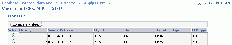

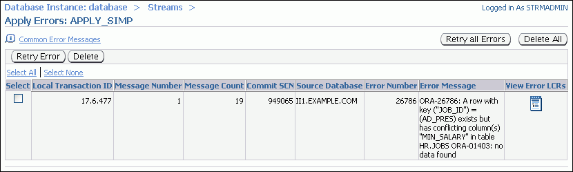

An apply error might cause an apply process to abort. When an apply process aborts, the status of the apply process is ABORTED.
Select the apply process with error transactions.
Click Errors to open the Apply Errors page.
You can view detailed information about an error by clicking the icon in the View Error LCRs field for the error transaction. The detailed information appears on the View Error LCRs page and includes each change in the transaction.
To drill down further, select a row change and click Compare Values. The Compare Values page appears and compares the row change with the data in the table to which the change should be applied. Click Help on the current page for information about the page.
On the Apply Errors page, complete one of the following actions:
To retry all error transactions, click Retry all Errors.
To delete all error transactions, click Delete All.
To retry a specific error transaction, select the error transaction and click Retry Error.
To delete a specific error transaction, select the error transaction and click Delete.
You can also use the following procedures in theDBMS_APPLY_ADM package to delete or reexecute error transactions:

To determine whether a large number of captured changes are spilling to disk, follow the instructions in "Viewing Statistics for a Capture Process". The Queue Statistics graph shows the current number of changes spilling to disk in the capture process queue.
