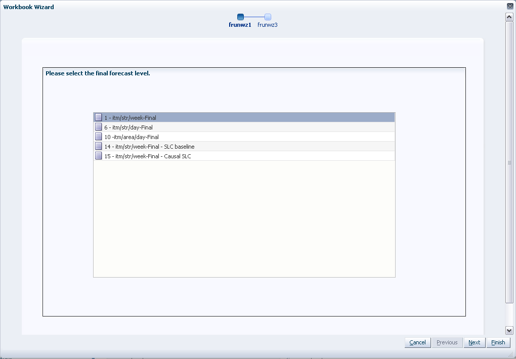

The Forecast Batch Run wizard opens and prompts you to select the Final Levels to forecast. Select Next or Finish.

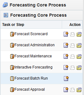

To build the Forecast Batch Run workbook, perform these steps:
Click the New Workbook icon in the Forecast Batch Run task in the Forecasting Core Process activity.
The Workbook wizard opens. Select the levels to work with and click Next.

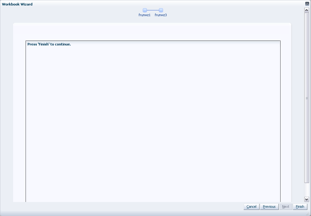

Verify and click Finish.
The Run Batch wizard automatically executes PreGenerateForecast and Generate within the Simple or Local Domain. Depending on the amount of product/locations to be forecast and the forecast horizon, it may take a several minutes before the system advances to the final window. When the forecast generation is completed, the wizard displays a window that notifies you of the forecast generation ID.
